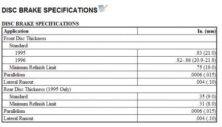

When replacing disc pads, what measurements do I need to check on a rotor to see if I can keep the rotors as is, turn them, or have to replace them? I have to measure the thickness of the rotors and check for scoring. If I need to check waviness as the rotor is turning or cupping from the inner part to the outer part, how do I do that?

Hi daveshmo,
When the surface of the rotors are smooth and you do not have vibrations when applying the brakes, you need not bother about the rotors.
Here are the specifications.
https://www.2carpros.com/forum/automotive_pictures/192750_DiscBrake95Civic_1.jpg
To test runout you would need a dial gauge
