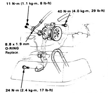

Last week the steering of the car all of a sudden became really hard and i ask a couple of my buds at work and they said it maybe the steering fluid so i been looking for it but it turns out that i can't find the reservoir if anyone could help me it would be greatly appriciated

I couldn't find a picture of the resivour, but here is a picture of the pump. If you follow the hose from the pump, it will lead you to the resivour.
https://images.2carpros.com/forum/automotive_pictures/249084_poop_1.jpg
Let me know if this helps. NOTE: the pump is on the passanger side of the engine compartment. It is run by the accessory belt. Joe
