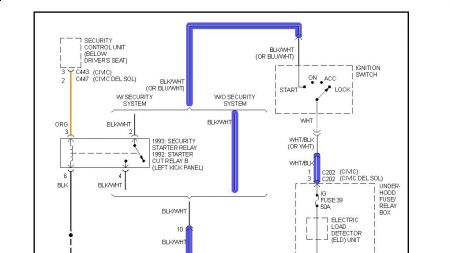

The car dosen't even turn over when I turn the key. I get all the dash lights but no starter noise not even a click to the starter.

Hi there,
With no starter power you will have to start checking the supply to the starter solinoid, first check that there is power to the small wire on the starter solinoid with the key on crank, if there is power there and there is power at the main cable the starter is faulty, if no power at the small solinoid wire you may have a faulty transmission isolator switch, check this first.
Mark (mhpautos)

Review the starting system EWD it will assist you in finding the trouble area
http://www.2carpros.com/forum/automotive_pictures/12900_start1_5.jpg
http://www.2carpros.com/forum/automotive_pictures/12900_start2_6.jpg
