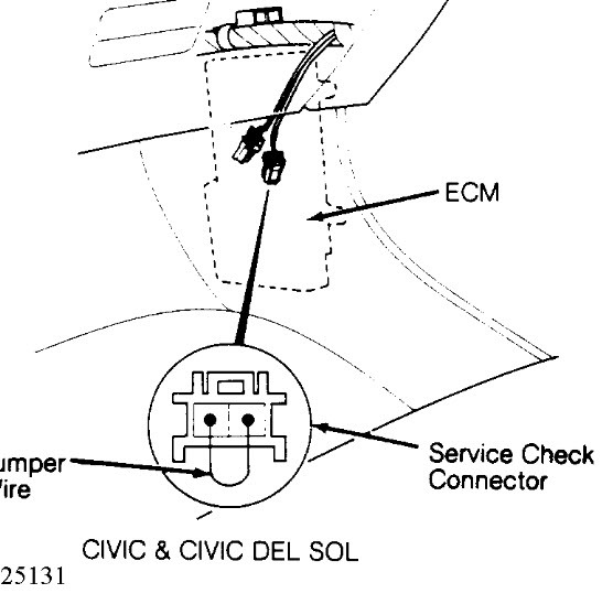

Can computer codes be read on a 92 Civic without an electronic code reading machine ? My car has code(s) stored but is not running in my driveway. It won't start. I can't take it anywhere to get the code(s) read. Can one make the dash light blink and get the codes ? If so, where do I go for an explanation ?
Feb 4, 2009 at 11:18 AM
HONDAMAN6200
  • 18 POSTS
Jim,
When you turn the key on does the check engine light come on for 2 seconds then go out? If so that part of the system is operating correctly. Now do this. There is a blue connector all the way to the right under the glovebox. You may have to dig for it. It may be taped to other wires or tucked behind the plastic cover to the right of where your feet go. This connector has 2 wires in it and does not plug into anything. OK, key off at this point. Your need to make contact between the two wires so that they touch each other. There is special connector we use to plug into it that does the same thing but you have to improvise. OK, now turn the key on and read the code if there is one. Long blinks count as 10. Short blinks count as 1. Example: four long blinks=40. Three short blinks=3. Hence, code 43. Try it and give me a holler if your stuck or when you retrieve the code or codes. There may be more than one code. They just keep repeating so watch it a while to learn the pattern. i will try and be here for you.

HMAC300
  • 48,601 POSTS
here is a picture to get the codes.
