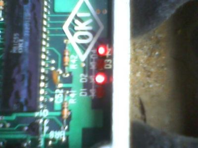

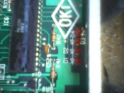

When I start the engine in the morning, normally the engine will work for about to minute without load i.E no head lamp on or other things, then engine will come down with low noise and less vibration. But now the engine after 15s to 20s it will rise again and you will here the manifold vibrating.
The LED D1, D2, D3 and D4 in the ECU.
As you starting the engine D4 and D2 light up the the engine high up D4 went off and D1 lit up at this time this air system become abnormal, if you press the accelerator the engine will start to make shooting sound and slow down later went off.
On the ECU there are three plug with bunch of cable if I remove the middle plug the and start the engine LED D2, D3 and D4 come on and the engine is normal but the PGM-FI light on the dash board will not work and after 1hour the engine will not start again until I plugged in the cable plug back.
(1) Is my ECU bad (2) is there any relay that is bad (3) is my PGM-FI bad. (4) is there any problem with Idle speed adjustment.
With all this problem the engine did not soak spark plug but there are black deposit on the spark plug.

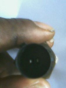

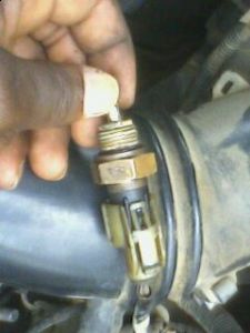

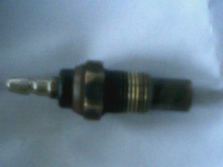

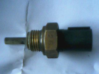

Maybe you should test the coolant temperature sensor and or it circuit. Your problem seems likely to be caused by it.
Friday, March 13th, 2009 AT 10:24 AM
CHRISLETUA
  • 16 POSTS
It is 1987 model yes it has 4 LED
Yes, it uses the binary system for counting the codes, with 8, 4, 2, 1
1 starting from right and is read leftwards. you are correct

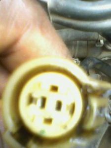

How can i locate the coolant temperature sensor coolant temperature sensor, is there any way to test
https://www.2carpros.com/forum/automotive_pictures/231560_Is_this_the_coolant_temperature_sensor_1.jpg
https://www.2carpros.com/forum/automotive_pictures/231560_The_socket_veiw_1.jpg
https://www.2carpros.com/forum/automotive_pictures/231560_is_this_the_right_coolant_temperaturesensor_with_plug_1.jpg
https://www.2carpros.com/forum/automotive_pictures/231560_Is_this_the_plug_to_the_coolant_temperature_sensor_1.jpg
https://www.2carpros.com/forum/automotive_pictures/231560_OR_is_this_the_right_sensor_1.jpg

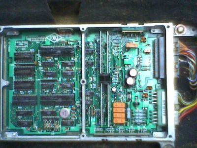

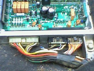

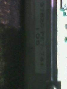

I am sending you the picture of the ECU. that is the tow LED that come on when the engine is runing
https://www.2carpros.com/forum/automotive_pictures/231560_ECU_1.jpg
Here is the one with the three plug on the side
https://www.2carpros.com/forum/automotive_pictures/231560_IMG0033A_1.jpg
https://www.2carpros.com/forum/automotive_pictures/231560_IMG0047A_1.jpg
now you can see the D1,D2 that I was telling you earlier.
more pix
https://www.2carpros.com/forum/automotive_pictures/231560_IMG0049A_1.jpg
https://www.2carpros.com/forum/automotive_pictures/231560_IMG0034A_1.jpg
https://www.2carpros.com/forum/automotive_pictures/231560_ECU_2.jpg
Awaiting your reply thanks.

The D1 to D4 are the circuit board schematic diodes.
I have the testing diagnostic for the various circuits but it is not the correct position as the ECU connectors unless you have the Diagnostic Harness Checker. Refer to lower diagram for wire colors. You can back probe the connectors by removing the ECU from its mounting points.
A = biggest connector ( white) you need to backprobe the C connector.
Note the wire colors at ECT, you have the correct pix of it.

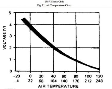

SELF-DIAGNOSTIC LIGHTS NO. 2 & 8 ON OR LIGHT BLINKS 10 TIMES
1. Plug system checker harness between ECU and connector. Connect voltmeter positive probe to terminal C5 (White/Red wire) and negative probe to terminal C12 (Green/White wire). Turn ignition on. Ensure voltage reading is correct for intake air temperature.
2. If voltage is correct, replace ECU and retest. If voltage is not correct, turn ignition off. Check for open/short circuit in White/Red and Green/White wires (Red/Yellow and Brown/Black wires on CRX Si) between intake air temperature sensor and ECU. Repair wiring if necessary. If wiring checks okay, check intake air temperature sensor. Replace sensor if defective. If sensor tests okay, replace ECU and retest.
https://www.2carpros.com/forum/automotive_pictures/192750_IATChart87Civic_1.jpg
