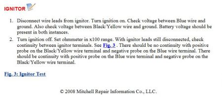

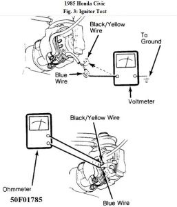

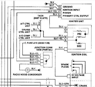

Is therre a way to test the ignition module when it is removed from the car? My daughter's Honda would not start one morning after running fine previously. Upon checking it out, I found that there was no spark. I checked the coil's continuity, plug wires, etc., and finally decided to replace the ignition sensing module in the distributer. Upon finding out the cost, $250 for the Honda part, $135 for the aftermarket part, I would like to verify if the module is, in fact the problem. It is odd that it would just quit overnight with no reason. Thanks for the help.

Hi Ralph, Here are the testing procedures.
https://images.2carpros.com/forum/automotive_pictures/192750_IgnitorSchematicHonda01_2.jpg
https://images.2carpros.com/forum/automotive_pictures/192750_IgnitorTest85CivicHitachi_1.jpg
https://images.2carpros.com/forum/automotive_pictures/192750_IgnitorTest85CivicHitachi01_1.jpg
