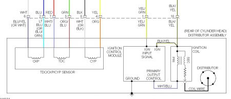

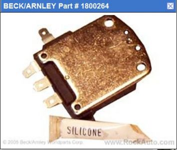

I just got an Ignition control module it came with a tube of heat sink I would like to know where do I apply it to the unit, and where would be the best place t find a diagram of the wiring to re install the new unit.
thank you

Found this wiring info. The silicone should go on the metalic side of ignition module.

Thank you for the wiring info, once I pluged the wires correctly the car started right up.
