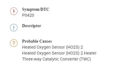

Car listed above is the EX; model, 2.3 liter engine with 115,000 miles. How can I isolate the issue? O2 sensor? Front or rear or both? Catalytic converter? Help please. CW

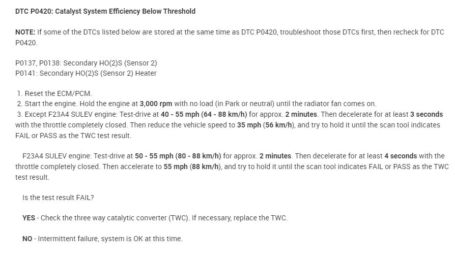

Good afternoon,
You will need a scan tool that can read the voltage of the upstream and downstream O2 sensors.
When the readings vary the same, that indicates the cat converter is bad. If the downstream sensor voltage stays stable, then it could be an exhaust leak in the system.
In most cases it is the cat converter, not the sensors. If they were bad, they would code separately for the sensors.
Mar 24, 2020 at 9:26 AM
Suggested Repair
Use a scan tool to compare upstream and downstream O2 sensor voltages. If both readings fluctuate the same way, the catalytic converter is likely bad. If the downstream voltage stays stable, check for an exhaust leak. Faulty sensors usually set their own codes.
