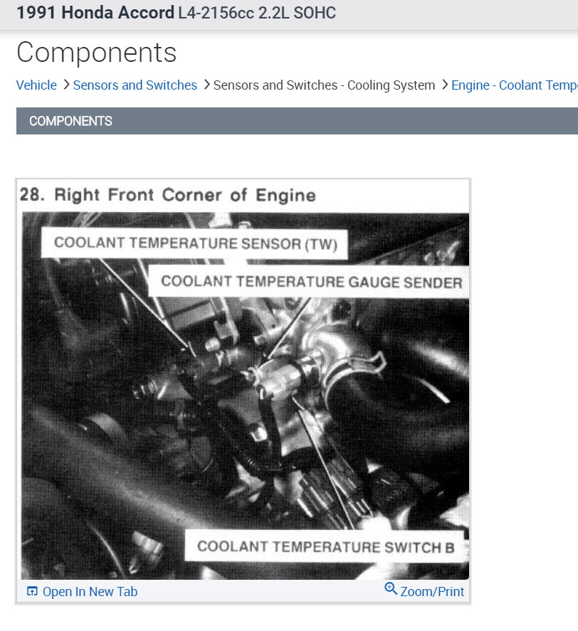

It started off getting hot in idle but would cool off once accelerating but ended up blowing head gasket. Going to put blue devil sealant in it and try to fix it. but my question is about the fans. it has got two fans on the radiator and it’s not working or kicking on. I believe one runs off the belt and the other runs off relay. I changed the thermostat and the radiator fan relay and it still isn't kicking on. what else could it be? The heat has never worked in it, but it blows it just don’t get hot.. what are some things I could do or check? please hit me back. thanks

There is a coolant temperature sensor in the radiator that goes out. here is the location so you can jump the wires to see if the fans turn on. Check out the diagrams (below). Please let us know what you find. We are interested to see what it is.
