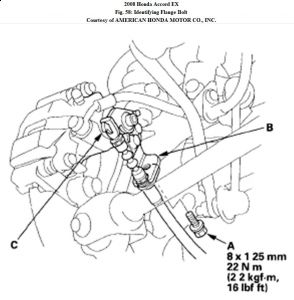

5. Remove the flange bolt (A) from the arm (B).
https://www.2carpros.com/forum/automotive_pictures/192750_RRBrakeDics08AccordFig58_1.jpg
6. Disconnect the parking brake cable from the lever (C).

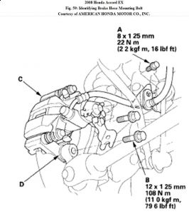

7. Remove the brake hose mounting bolt (A).
https://www.2carpros.com/forum/automotive_pictures/192750_RRBrakeDics08AccordFig59_1.jpg
8. Remove the brake caliper bracket mounting bolts (B), and remove the caliper assembly (C) from the knuckle. To prevent damage to the caliper assembly or brake hose, use a short piece of wire to hang the caliper assembly from the undercarriage. Do not twist the brake hose and the parking brake cable excessively.
NOTE:
Make sure the plates (D) are in position on reassembly, if they are removed

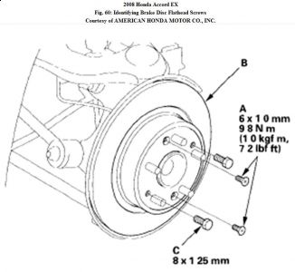

9. Remove the brake disc flathead screws (A).
https://www.2carpros.com/forum/automotive_pictures/192750_RRBrakeDics08AccordFig60_1.jpg
10. Remove the brake disc (B) from the hub bearing unit.
NOTE:
If the brake disc is stuck to the hub bearing unit, thread two 8 x 1.25 mm bolts (C) into the brake disc to push it away from the hub bearing unit. Turn each bolt 90 degrees at a time to prevent the brake disc from binding.
