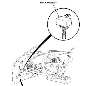

The shift light blinking and non starting are usually caused by a faulty PGM-FI main relay.
https://www.2carpros.com/forum/automotive_pictures/192750_PGMFIRelay90Accord_4.jpg
Did you check if the spark plug wires were correctly installed?
Are you getting sparks at the plug wires?
If you had removed the thermostat housing, recheck the ground wire installation on the housing.
