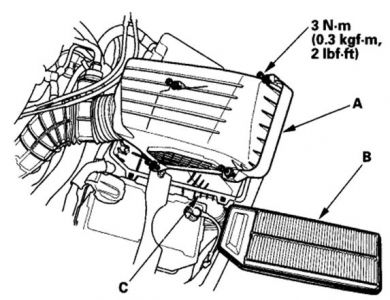

Looking for help locating and changing air filter on 2007 Accord, 4 cyl

Air Cleaner Element Inspection/ Replacement
https://images.2carpros.com/forum/automotive_pictures/12900_af_3.jpg
1.Open the air cleaner housing cover (A). 2.Remove the air cleaner element (B) from the air cleaner housing (C). 3.Check the air cleaner element for damage or clogging. It needed, replace the air cleaner element. NOTE: Do not use compressed air to clean the air cleaner element. 4.Clean and remove any debris from inside the air cleaner housing. 5.Install the parts in the reverse order of removal.
