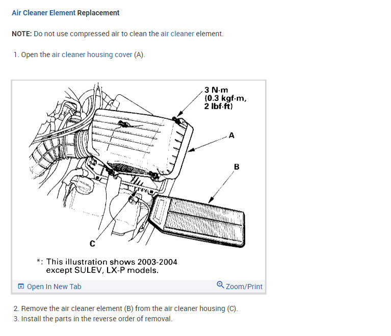

Changing Air Filter?
SCHMUGGS
  • 2005 HONDA ACCORD
  • 4 CYL
  • FWD
  • 70,000 MILES
Sounds simple but in the 2005 Accord, I can undo the 4 screws simply enough, but can't seem to lift the cover off, as it bumps into the front left side of the car.
Any tricks I need to know?
Saturday, July 5th, 2008 AT 9:11 AM
The trick to this is to remove the hose from the air box first and then you can remove the screws and the top will come off easier.
Here is a guide that will help with this as well:
https://www.2carpros.com/articles/how-to-replace-a-car-air-filter
Lastly, I attached the info below from the manual that will help as well. Let us know what other questions you have. Thanks
