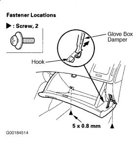

2007 Honda Accord 4 cyl Front Wheel Drive 23,500 miles
I would like to know the procedures to simply change my cabin air filter on my vehicle. Also, canyou advise as to how to stop rattling on the driver side door. Car has been taken to dealer more than five times and still rattles...

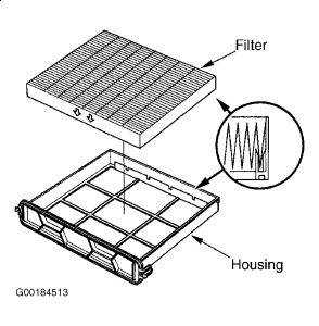

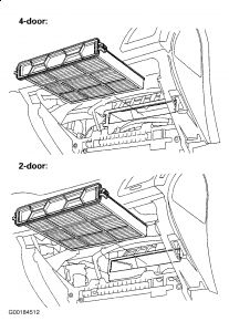

CABIN AIR FILTER Removal & Installation Open the glove box. Remove the damper from the glove box then let the glove box hang down. Remove the dust and pollen filter assembly from the evaporator case. Remove the filter from the housing and replace the filter. Install the filter in the reverse order of removal. Ensure arrow marks on edge of filter point in direction of air flow. Make sure that there is no air leaking out of the evaporator.
