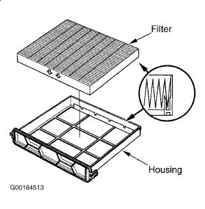

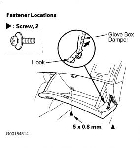

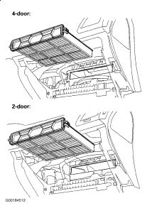

I just need to know how to acccess the cabin filter so I can change it.
May 12, 2009 at 8:58 AM
BMRFIXIT
  • 19,053 POSTS
Removal & Installation Open the glove box. Remove the damper from the glove box then let the glove box hang down. Remove the dust and pollen filter assembly from the evaporator case. Remove the filter from the housing and replace the filter. Install the filter in the reverse order of removal. Ensure arrow marks on edge of filter point in direction of air flow. Make sure that there is no air leaking out of the evaporator.
