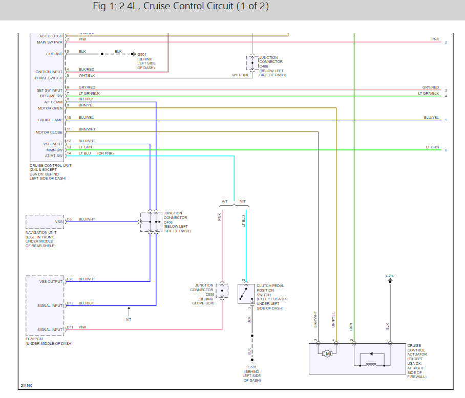

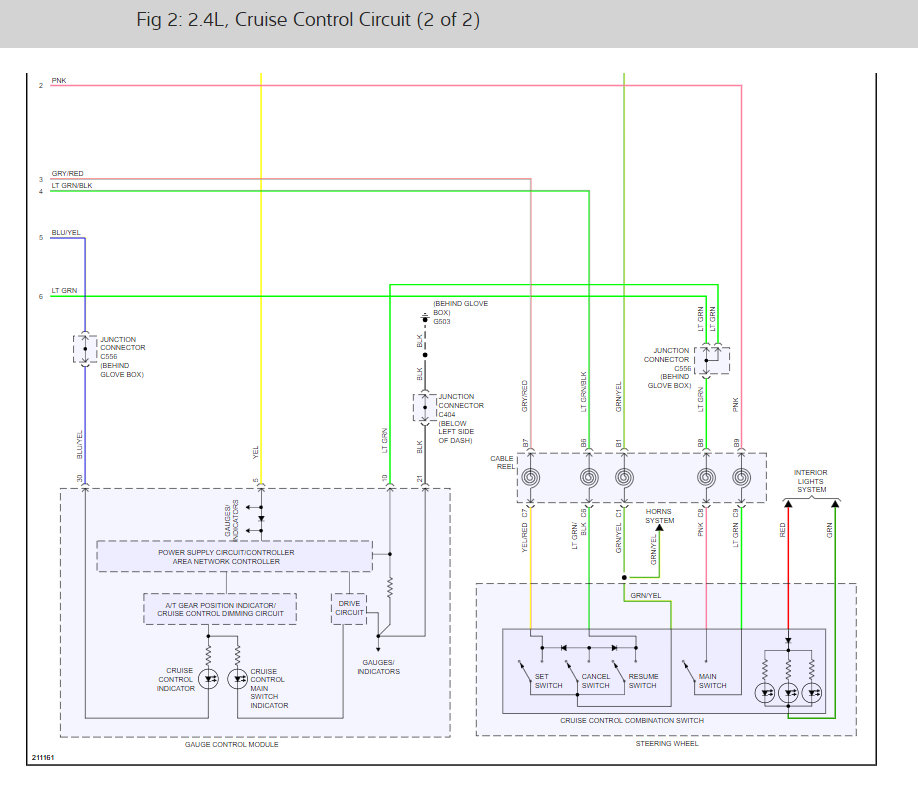

The car just started having an intermittent cruise control problem. Sometimes when I set the cruise control, it automatically disengages after driving about 10 miles without me touching anything and the main light remains lit. I then hit resume, and nothing happens as it the memory is cleared out. I then reset the speed and sometimes it works fine, and sometimes it shuts off again a few miles down the road. I haven't noticed the problem when going to work when its cooler, it usually happens on the way home when it is hot outside. Does anyone have an idea of what the problem may be?
Sep 1, 2010 at 11:40 AM
KHLOW2008
  • 41,814 POSTS
Hi rah140,
Nine times out of ten its the clock spring behind the steering wheel shorting out but to be sure here is the cruise control wiring diagrams so you can see how the system works and a guide to help you test the connections.
To perform a simple test, when problem occurs and you are not able to set the cruise control, use your left foot to lift the brake pedal and if it works, the brake switch is out of adjustment. They call the clock spring the cable unit FYI.

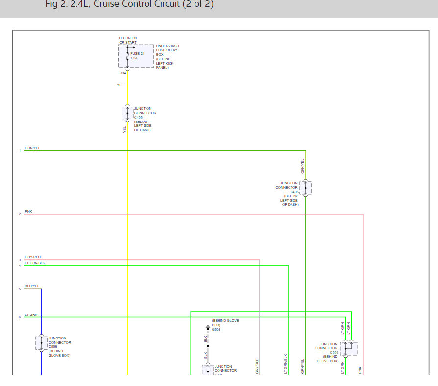

Rah140,
Thanks for this post I used the guide and wiring diagrams to confirm it was the clock spring cost me $143.00 for anew one works great! I love this site.

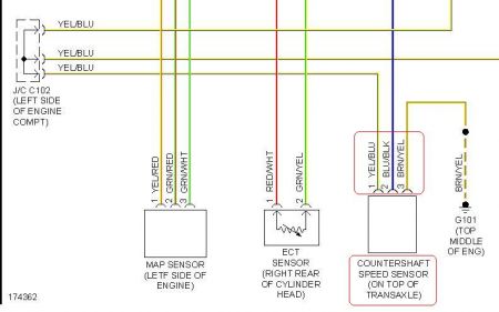

INDORUWET
Exactly where is the VSS wire and the Tach wire ?
I am in the process of installing an after market cruise control, and the last two wires need to be connected to the connections mentioned above.
A small pictorial representation would be greatly appreciated if at all possible.
TIA
Oct 23, 2019 at 11:24 AM (Merged)
BLUELIGHTNIN6
  • 16,542 POSTS
The vehicle speed sensor is located on top of the transaxle. If the vehicle is equipped with a tachometer, then it will be ran by the speed sensor as well. Diagram of wires from the speed sensor is below. I have highlighted the appropriate wires for your convenience. NOTE: The blue wire continues on to the PCM off screen.
https://images.2carpros.com/forum/automotive_pictures/261618_Noname_96.jpg
Hope this helps.. Thanks for using 2carpros.com!

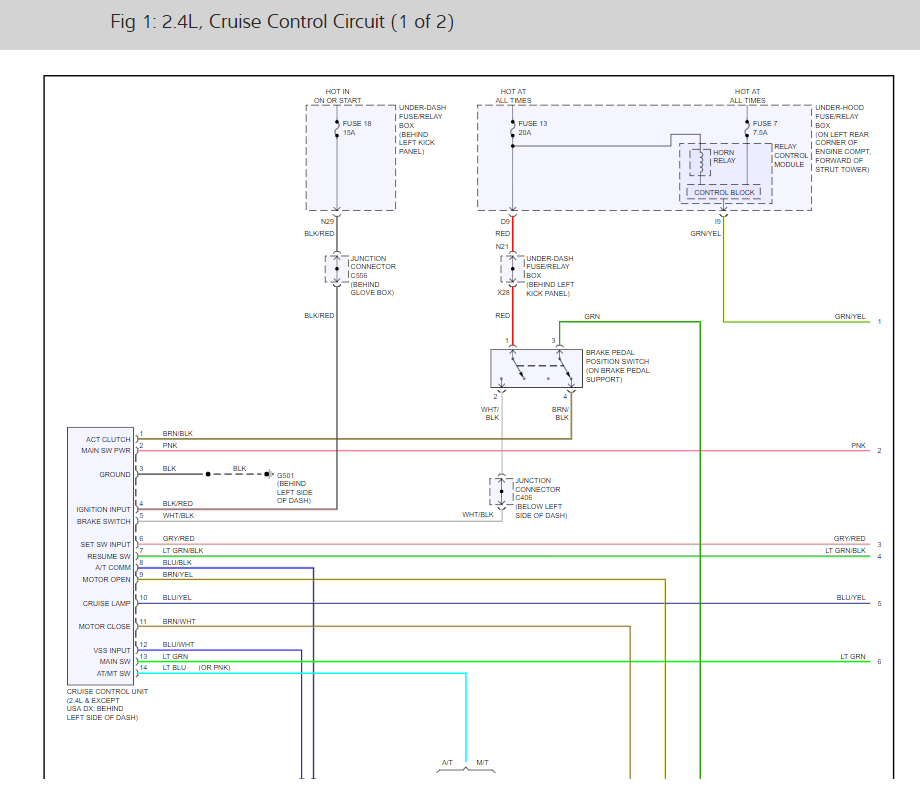

2000 Honda Accord 4 cyl Two Wheel Drive Automatic
Sometimes when running with cruse and apply brakes the engine will speed up and the car feels like it does not want to stop.
KHLOW2008
  • 41,814 POSTS
Hi Bart Jones,
Problem seems to be a faulty brake switch. It is not sensing and disabling the cruise control when brakes are applied.

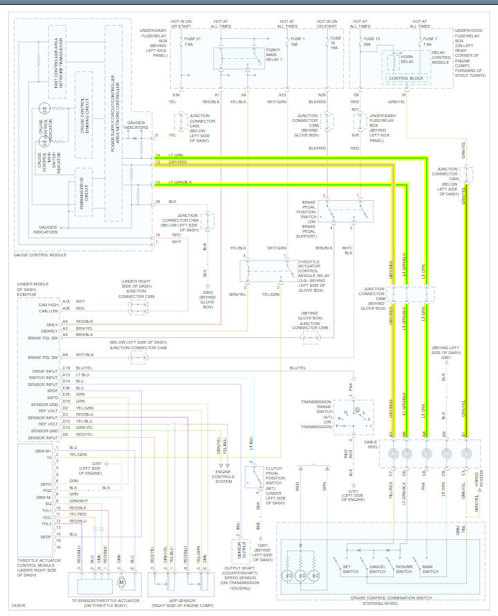

My car Accord 2007 cruise control not working. The cruise control does not work and the slide has been changed inside the steering wheel, but the cruise control is disconnected and reinstalled again.
Jul 14, 2021 at 3:38 PM
If your clock spring has been changed then we need to find a little more detail out about what your cruise is doing. When you press the buttons, do any of the lights come on that show the cruise is on? Does it just not engage the cruise?
Basically we need to know if you are getting voltage from the buttons to the gauge control module. The way this works, is the buttons tell this module that you have pressed the button and it then sends the correct signal to the throttle control actuator.
We are going to have to track voltage through the system and find out where we are losing it.
The issue is you are not going to be able to track voltage from the gauge module to the throttle module as that is what is called a bus network and it sends coded messages to tell it what to do. Here is a guide that talks about this:
Let us know if you have voltage at the gauge module on the circuits highlighted below and we can go from there. Or if the cruise indicator is working then we can make an assumption at this point that this is working.
