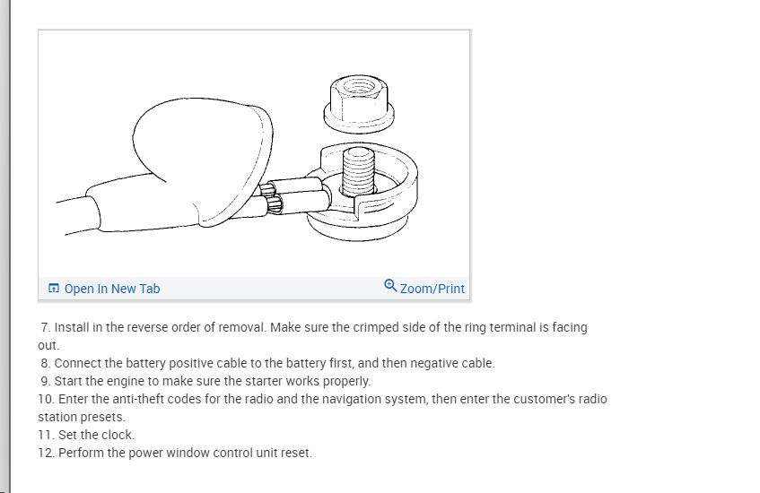

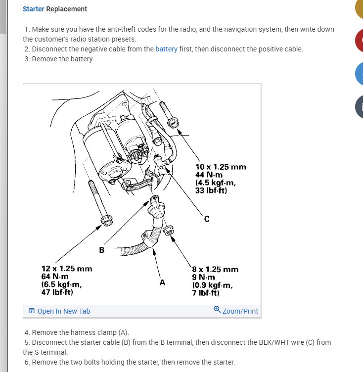

I assume the engine didn't actually start. If this is the case, then you have a starter or battery issue.
This sounds like a battery more than anything else, so we need to start there.
Here is a guide that will help with this:
Once we know if the battery was the issue or not, then we can move onto the starter if it was not.
More than likely if the battery passes the load test, then the starter will need to be replaced so I attached that info below.
Please run through this info and let me know what questions you have.
