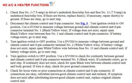

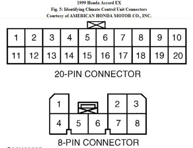

LETZGAR
Air Conditioning problem
1999 Honda Accord 4 cyl Front Wheel Drive Manual
AC dont´t work, the AC Pannel it´s powered off
Apr 25, 2020 at 11:53 AM (Merged)
KHLOW2008
  • 41,812 POSTS
Hi letzgar, Here are the diagnostics.
https://images.2carpros.com/forum/automotive_pictures/192750_ACHeaterTest99Accord_1.jpg
https://images.2carpros.com/forum/automotive_pictures/192750_ACpanelConnector99Accord_1.jpg
