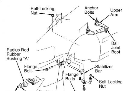

Car makes noise as if squeaker on brakes is warning me, however, at the time I am not using the brakes.
I've noticed that "sometimes" after I have completed a right turn I hear the squeak and what sounds like change jingling, other times it happens when going over a bump or changing lanes on freeway. I cannot make it do this at will. At one point after the jingling sound there was a low "rubbing" sound afterwards.
Am I looking at $$$$ repair?

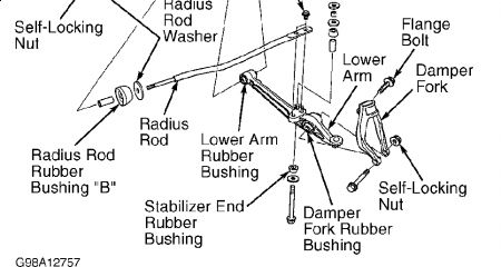

Look at the ball joint, strut, and link rubber mounts, and the brake wear indicator CAN make noise without applying the brakes!
