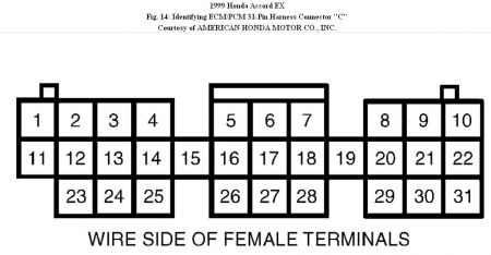

Hey there thank you for telling me. i unplug the wire to told me, but when i do that the gauge goes all the way down to cold and if i plug it back it will go all the way back to high. can you tell me more information please? thank you.
Jun 8, 2010 at 7:23 AM
KHLOW2008
  • 41,812 POSTS

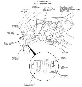

Try the following test to see if you can come up with anything. Coolant Temperature Gauge Needle Goes Past Hot Mark (Four Cylinder) 1. Turn ignition off. Disconnect ECM/PCM 31-pin connector "C". Turn ignition on. Observe coolant temperature gauge for at least 30 seconds. If coolant temperature gauge needle moves at all, go to next step. If coolant temperature gauge needle does not move, replace ECM/PCM with known-good ECM/PCM and retest gauge operation. 2. Turn ignition off, then turn ignition on again. Observe coolant temperature gauge. If coolant temperature gauge takes less than 30 seconds to go past hot mark, replace fuel and temperature gauge assembly. If coolant temperature gauge takes 30 seconds or more to go past hot mark, go to next step. 3. Turn ignition off. Pull out instrument cluster. Disconnect instrument cluster 16-pin connector "C". Check continuity between ground and ECM/PCM connector "C" terminal No. 24 (Yellow/Green wire). See Fig. 14. If continuity exists, repair short to ground in Yellow/Green wire between ECM/PCM and instrument cluster. If continuity does not exist, replace fuel and temperature gauge assembly.
