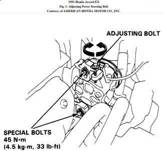

Hi we have a 1991 Honda Accord and our Power Steering Belt is damaged and we purchased a used one that is not broken and we need help on how to install it so nothing goes wrong.

Hi Rashum,
Here are the procedures.
ADJUSTMENT
1. Loosen the mounting bolt and locknut.
2. Turn the adjusting anticlockwise to loosen the belting for removal and installation of the new belt.
3. Install new belt and check that it is seated correctly by pulling at it ti let it slip over the pullies.
4. Turn the adjusting bolt to obtain the proper belt tension, then retighten the locknut and mounting bolt.
5. Recheck the belt tension.
6. Run the engine for 5 minutes, then readjust the belt to the used belt specification.
https://www.2carpros.com/forum/automotive_pictures/192750_PSBelt91AccordFig01_1.jpg

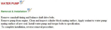

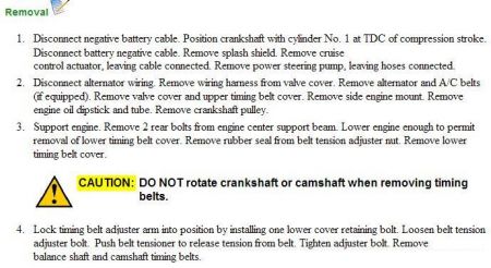

Can you give me instructions on how to replace the timing belt and water pump on a 91 Accord w/automatic trans

https://www.2carpros.com/forum/automotive_pictures/261618_Noname_1101.jpg
https://www.2carpros.com/forum/automotive_pictures/261618_Noname2_316.jpg
https://www.2carpros.com/forum/automotive_pictures/261618_Noname3_118.jpg
