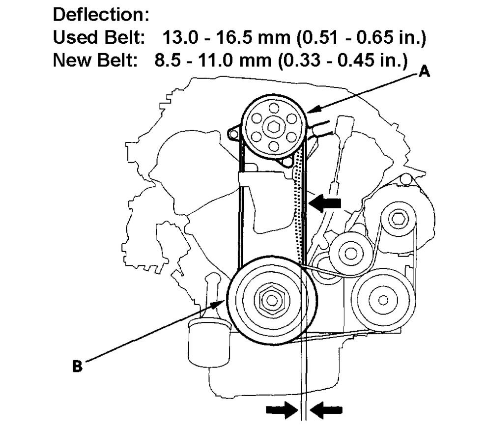

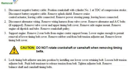

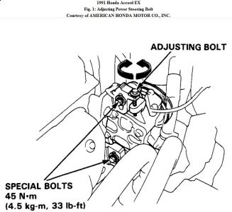

How do you replace the power steering belt on a 99 Accord EX V6. Do you support the engine at the oil pan and remove the engine mount to replace the belt?
Looking at the engine, after the pump is adjusted to give slack in the belt it will come off the pump. However it also goes around the engine mount down to the fly wheel pulley. The old one could be cut off however to get the new one on you have to get it around the engine mount somehow. I have shop manuals for the vehicle but they only reference adjusting the tension & how to check the tension. There is nothing in the manual about replacing the belt, only adjusting it.

That's one way to do it it say's to use a belt bar to remove the belt then use it to put a new one on. It doesn't mention removing the mount, but judging by the picture below you might need to

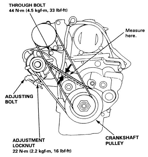

First you would need to remove the power steering belt.
Loosen the pump holding nuts at top and below the pump and you can push the pump inwards to loosen the belt to remove it.
Repeat with the alternator/air cond compressor belt by loosening the adjustment lock nut below the alternator. Turn the adjusting bolt anticlockwise to loosen the belt tension and remove.

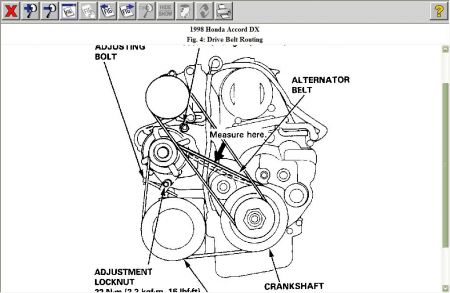

I have been looking for some guidance about changing the two belts in my car. I have an idea of how, but I want to be sure before starting to do it.

REMOVAL & INSTALLATION

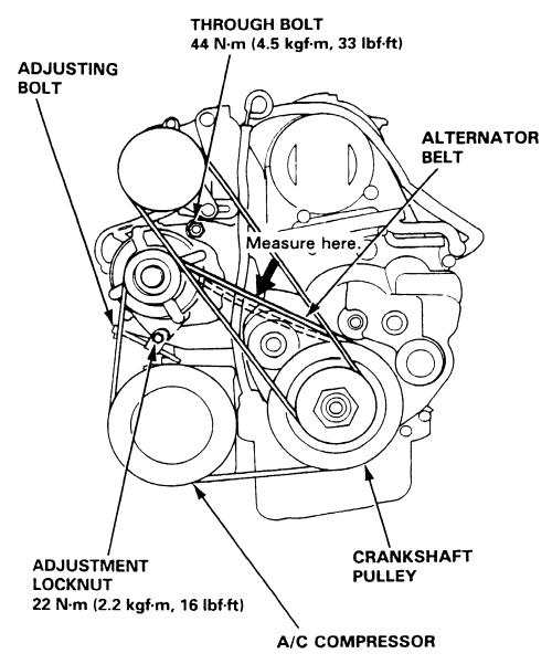

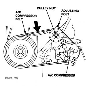

I have a haynes manual and the instructions for replacing any belts just says to loosen the tensioner bolt and the adjustment bolt. However when I got down to it I only found one pully assembly that had what I thought would be a tensioner bolt or an adjustment bolt. However tighten or loosen either or all of the bolts on this assembly and the pully doesnt move. Am I missing something? How do I get the belt to go on if I cant adjust the tension to get it to slip over the pulley? Any advice on replacing this belt would be very appreciated.

If yours looks like the pic I included,(A/C) you have to loosen the nut in the center of the pulley to be able to adjust it.The alt should have a lock nut on the top pivot bolt and an adjusting bolt on the same mount that you llosen to change the belt

I will go back at it again this afternoon. I knew it was something simple like this, ur a godsend sir.
