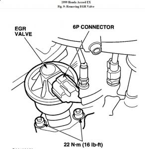

how do i find and change the EGR valve?

Hi adebty, Here is a diagram of the EGR valve.
https://images.2carpros.com/forum/automotive_pictures/192750_EGRValve99Accord6cylFig09_1.jpg
Replacing the valve might not solve the problem of insufficient flow as the port under it needs to be cleaned and that requires quite a lot of work. Get a can of carb cleaner to clean the EGR valve and retest instead of replacing it. Spray the cleaner into the port and if possible, get some sort of flexible wire ( I use broken meter cables attached to a hand drill ) to clear the ports.
