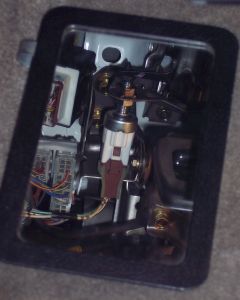

https://images.2carpros.com/forum/automotive_pictures/535400_1998HondaAccordLXbrakeswitchcropped_1.jpg
Hi KHLow2008, Thank you for your quick and helpful reply regarding the cruise control problem on my 1998 Honda Accord 4 cyl Two Wheel Drive Automatic 160K miles. In regards to "The brake switch works on 2 different circuits, one for the brake lights and the other circuit is for the cruise control," how would I test the two different circuits? The Haynes manual indicates, "The break pedal position (BPP) switch (or stop lamp switch) deactivates the cruise control system. Have an assistant press the brake pedal while you check the stop lamp operation." If there is more testing that can be done, it may not be covered in the Haynes manual. I will take a closer look at the switch. [Mirror image photo now posted above.] I recall seeing a button (near the mechanical mechanism below the dash) that moves when the brake pedal moves, but did not pay attention to the number of wires connected to the switch. In regards to, "Have you gone through all the diagnostic steps?" I have followed what is listed in the Haynes manual, with the exception of checking out the "vehicle speed sensor on the mainshaft" as I indicated above. A side thought on that, the tachometer works, and I might be able to try running the engine with and without that connected to demonstrate the sensor works. While admitting that I am not an auto-mechanic, I am suspicious of the set of controls (RESUME/accel, CANCEL, SET/decel) mounted on the right hand side of the steering wheel. That is directly tied to the function that does not work, and there was no testing of that in the Haynes manual. What are they connected to? Could a wire have come loose when some other work was previously done on this car?

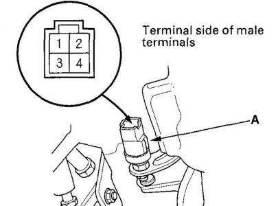

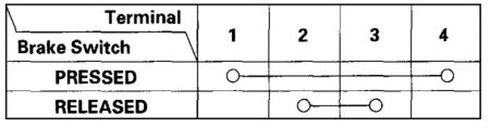

https://images.2carpros.com/forum/automotive_pictures/535400_98Accordbrakeswitchterminals_1.jpg
https://images.2carpros.com/forum/automotive_pictures/535400_98Accordbrakeswitchcontinuity_1.jpg

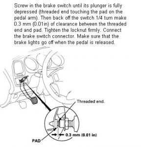

KHLow2008, To test the break switch, I disconnected the 4P connector and used an ohm meter to test continuity. With the brake pedal released, there is no continuity at all. With the brake pedal pressed, there is continuity between terminal 2 and 3. When I put a small flat shim between the released brake pedal and the switch, I do get continuity between 1 and 4. I believe the problem is as you described, "If there is too much clearance between the brake pedal and switch, the cruise control would not work." It turns out that if I had looked in the Haynes manual section focused on the brake switch (rather than cruise control), I would have found some useful information regarding testing, but the adjustment information provided leaves me wondering if there is a smarter, easier way. That was the case with your suggestion regarding an easy test. Any suggestions on how to adjust this properly will be appreciated. It looks like I should be able to loosen one nut on the brake switch, move the switch toward the brake pedal, test/adjust and tighten the nut. Is it that easy? It seems worth asking because brakes and brake lights are things that I want to work for safety reasons. [Edit: See image below. The adjustment seems to be straight forward.]
https://images.2carpros.com/forum/automotive_pictures/535400_98Accordbrakeswitchadjustment_2.jpg
Thanks so much for your help. Gordon [Update: Adjusted the clearance on the brake switch and cruise control now works!!! One odd thing, the (1, 4) and (2, 3) pairings on the diagram above were opposite of what I measured - or I misread the numbering.]

BRAKE PEDAL POSITION SWITCH TEST
1. Disconnect the 4P connector from the switch (A).
2. Remove the brake pedal position switch.
3. Check for continuity between the terminals according to the table.
4. If necessary, replace the switch or adjust the pedal height.
gordon2's 12 June reply described the brake switch test. Refer to the diagram in that post.
