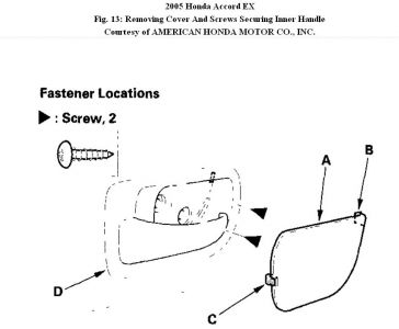

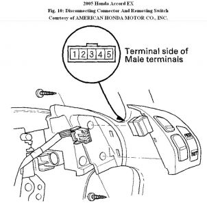

1) what is the best way to replace the cruise control swith, and 2) what is the best way to replace the front interior door handles

Hi dschendt, Replacement procedures are standard and there are no best ways as jobs are straight forward. CRUISE CONTROL COMBINATION SWITCH REPLACEMENT SRS components are located in this area. Review the SRS component locations and precautions and procedures , before doing repairs or service. 1. Remove the driver's airbag 2. Remove the two screws, then disconnect the connector, and remove the switch.

Using a trim tool, pry out on the rear portion of the cover (A) to release the hooks (B, C), then remove the cover and the screws securing the inner handle (D).
