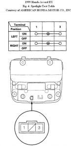

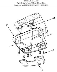

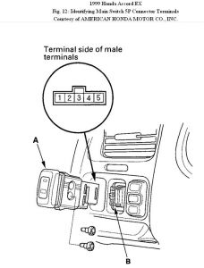

My two front spotlights at the top near my sunglasses holder went out about a couple of weeks ago. I turned off my engine to go inside and when I came back out and started my car, they wouldnt work anymore. They used to make a click noise when I turned the light on, but now, they dont even make any noise at all. I checked the fuses, but they all seem to be fine. Also, the green lights that were behind my cruise control button are out. How do I fix that?

1.Carefully pry off the lens (A) with a small screwdriver.
https://www.2carpros.com/forum/automotive_pictures/192750_SpotLight99AccordFig03_1.jpg
2.Remove the four mounting screws (B).
3.Disconnect the 3P connector (C) from the housing (D).
4.Check for continuity between the terminals in each switch position according to the table.
https://www.2carpros.com/forum/automotive_pictures/192750_SpotLight99AccordFig04_1.jpg
As to the cruise control main swithback light, pry the switch out and you can replace the bulb as indicated in the diagram.
https://www.2carpros.com/forum/automotive_pictures/192750_CruiseControlMainSwitch99AccordFig12_1.jpg

Thank you so much! I have looked all over for something that would help me with that dang spotlight. I am a visual person, and the diagram is perfect! Thanks again!
