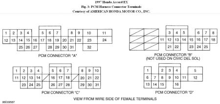

Four cylinder two wheel drive automatic 192,000 miles.
Do you need to put grease or lubricant on your VSS? I have my VSS replaced and after five months my speedometer suddenly stop functioning and my check engine light is on. What other reason might cause my speedometer not to function?

Hi japslico,
A little grease at the VSS pin between the sensor and meter gear is required.
Speedometer not working are usually due to faulty VSS. It could also be due to the meter gear that is plugged into the transmission, but rarely occurs. Check for loose electrical connector at the VSS.
For the CEL, it could be triggered by the VSS malfunctioning and to understand if it is related, get a free scan done at Autozone to see what codes are stored.

I have replaced the VSS again with a new one and after a week it drops to zero again and the check engine light is on. How do I repair the metal gear that connects the VSS or I need to have a mechanic to have it checked? Will it also be a faulty signal generator? Thank you for your informative advice.

Here are the procedures for testing the VSS operations: DTC P0500 & P0501: VSS RANGE/PERFORMANCE PROBLEM 1. Test drive vehicle. Using scan tool, check vehicle speed. If correct speed is not indicated, go to next step. If correct speed is indicated, problem is intermittent, system is okay at this time. Check for poor connections or loose wires between VSS and PCM. Repair as necessary. 2. Turn ignition off. Block rear wheels and set parking brake. Raise and support front of vehicle. Turn ignition on. Block right front wheel and slowly rotate left front wheel by hand. Measure voltage between PCM connectors terminal A9 and terminal C18. See Fig. 3 . If voltage does not pulse zero and 5 volts, go to next step. If voltage pulses zero and 5 volts, substitute a known-good PCM and recheck. If symptom or indication goes away, replace original PCM. 3. Turn ignition off. Disconnect PCM 31-pin connector "C". Turn ignition on. Block right front wheel and slowly rotate left front wheel by hand. Measure voltage between PCM connector terminal A9 and terminal C18. If voltage pulses zero and 5 volts, substitute a known-good PCM and recheck. If symptom or indication goes away, replace original PCM. If voltage does not pulse zero and 5 volts, repair a short or open in wire between PCM and VSS. If wire is okay, check VSS.

I have my VSS replaced and the wiring checked by a mechanic and the check engine light was gone. I drove the car for almost five hundred miles then the speedometer was intermittent again and the check engine light went on. I have it checked by Autozone scanner and it is showing P0501 and P0113.
How does this code affect the performance of my car and what is the best solution to my constant VSS problem?

Was the VSS replaced new or used?
Is it OEM?
For the VSS, the diagnostic procedures were outlined in previous post.
A VSS fault would result in erratic shifting.
DTC P0113: INTAKE AIR TEMPERATURE (IAT) SENSOR HIGH VOLTAGE INPUT
1. Turn ignition on. Check IAT sensor using scan tool. If -4°F (-20°C) or less is indicated, go to next step. If -4°F (-20°C) or less is not indicated, problem is intermittent. Check for poor connections or loose wires at Gray 14-pin connectors (located near right and left shock towers), IAT sensor connector, and PCM connector.
2. Disconnect IAT 2-pin connector. Install jumper wire between IAT sensor connector terminals. Using scan tool, check intake air temperature. If -4°F (-20°C) or less is indicated, go to next step. If -4°F(-20°C) or less is not indicated, replace IAT sensor.
3. Turn ignition off. Connect jumper wire between PCM 16-pin connector "D" terminal D8 and terminal D11.Turn ignition on. Using scan tool, check intake air temperature. If -4°F(-20°C) or less is not indicated, repair open in wiring between IAT sensor and PCM connector "D". If -4°F (-20°C) or less is indicated, substitute a known-good PCM and recheck. If symptom or indication goes away, replace original PCM.
