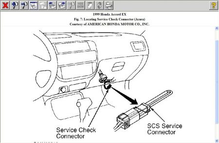

I recently purchased a transmission off the junkyard because my transmission wouldn't reverse anymore so i installed the one i just purchased and im having the same problem still and on the panel the d4 light stays blinking, it only goes forward and when i put it on neutral or reverse it make a really loud noise please help me to understand the problem..

Hi rios_isabel, Thank you for the donation. When the D4 lamp is blinking, an error has been detected by the PCM and you need to retrieve the Diagnostic Error Code.
https://images.2carpros.com/forum/automotive_pictures/192750_SCS99Accord_2.jpg
Connect the SCS with a jumper as illustrated and turn ignition switch on. Count the flashes on the D4 lamp, long flash = 10. Short flash = 1 Let me know the code.
