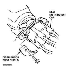

Hey,
I've done my research and cannot figure out how to fix the problem.... I have replaced everything electrical from and including the ecu to the spark plug and inside the distributor. Still getting the code. I put octane boost in it still nothing. Changed the injectors(all). I also have checked the compression. Everything that I researched on has been done. What else am I missing?

I am not sure if this applies to you, but there is a TSB on V6 to replace the distributor cap and to install a dust shield.
https://images.2carpros.com/forum/automotive_pictures/55316_accordcap_1.jpg
It is worth to check
