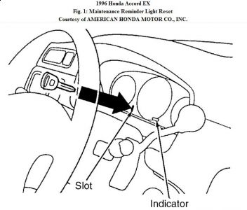

Asked my brother and he said its not my engine light thats on, its the red maintenance light. So now Im back to just my transmission problem. It was 1/2 qt low about three weeks ago after not checking for I don't know how many years (terrible). Now since adding and checking every day for three weeks the transmission fluid level has remained okay. Still feel though the shifting is sluggish and wonder about the trottle recall. Do you suggest that I just have my Honda dealer check out? Im at 99,000 mi and want to keep and get 100 T more miles so will start really taking care of her. Tnx so much, Sharon
Thursday, June 18th, 2009 AT 12:06 PM
KHLOW2008
  • 41,814 POSTS
Hi Sharon,
The maintenance service reminder can be reset to green by inserting the ignition key into the slot as shown in diagram.
https://www.2carpros.com/forum/automotive_pictures/192750_SESreset96Accord_1.jpg
If you feel the trans is not shifting correctly, it would be advisable to get it checked. Call the honda dealership and check if you can get the throttle replaced under the recall.
Thursday, June 18th, 2009 AT 12:32 PM
NELLYB123
  • 6 POSTS
Wonderful info; tnx so much and great clear diagram. Will set up appt with dealer. Sharon
