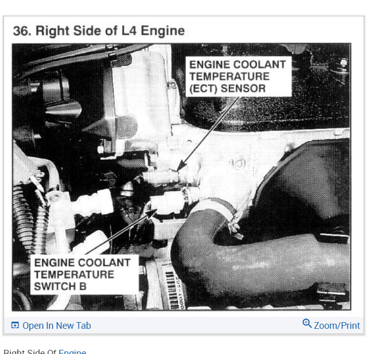

ESAU RAMOS
my honda will not start in the mornings specially when cold weather...it took long sometimes 30 to 60 minutes or more...rest of the day is just fine.
there is no "check engine" light.
Oct 5, 2009 at 5:45 PM
  • 75,992 POSTS
This sounds like you have a engine coolant sensor that needs to be replaced here is a guide that will walk you through the steps and the location of the sensor in the diagrams below.
https://www.2carpros.com/articles/coolant-temperature-sensor-cts-replacement
this guide can help as well
https://www.2carpros.com/articles/engine-cranks-excessively-before-starting
Check out the diagrams (Below). Please let us know what you find.
Oct 5, 2009 at 6:15 PM
ESAU RAMOS
You helped me so much!! thank you :) all fixed cost me $34.00 for the sensor.

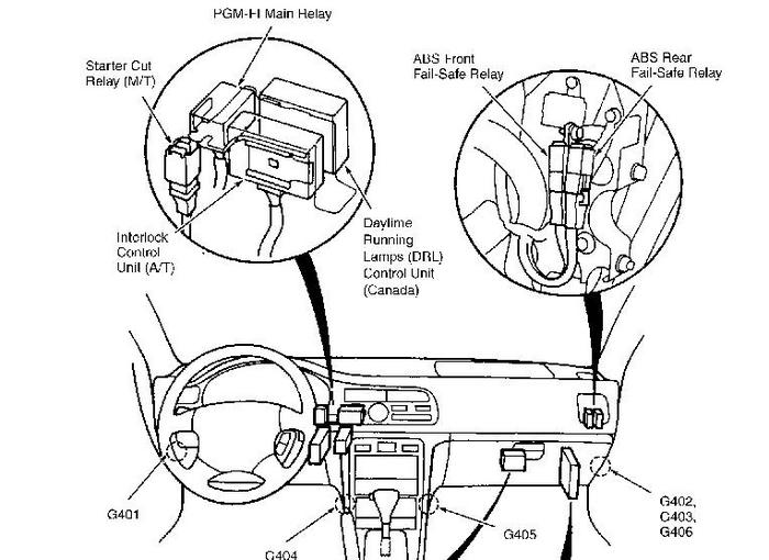

KHLOW2008
  • 41,814 POSTS
Symptoms indicates a possible PGM-FI main relay which are known to intermittently fail. When this occurs, the D4 indicator and/or Check Engine Light might not turn off after 2 seconds when ignition is turned on.

DJPETERB
Electrical problem
1995 Honda Accord 4 cyl Front Wheel Drive Automatic
My Honda want start after a good rain. When it is hot and dry it will start just fine. Noticed that when this happens the drive light is flashing......
Feb 11, 2019 at 11:21 AM (Merged)
KHLOW2008
  • 41,814 POSTS
Hi djpeterb, Symptoms described is most probably caused by a faulty PGM-FI main relay that is intermittently malfunctioning. Remove the relay and resolder the circuit board and it should solve the problem.

DJPETERB
Changed main relay. Did not work
KHLOW2008
  • 41,814 POSTS
Did you use a new or used relay?
When D4 light is blinking and starting is impossible, it usually is the main relay or its circuit. The worse case scenario would be the engine computer.
Did you check the main relay circuit board?
