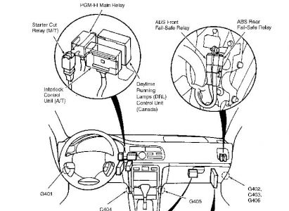

Hi nat ned,
Seems you are having a problem with the PGM-FI main relay. Remove it to check for bad circuit board and resolder if you find any cracked soldered points.
https://www.2carpros.com/forum/automotive_pictures/192750_PGMFIRelay95Accord_1.jpg
