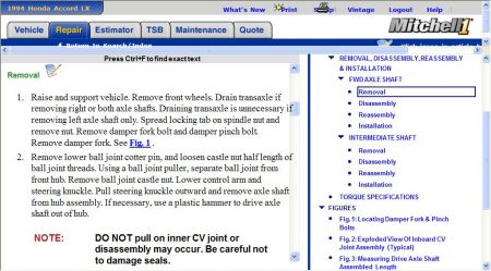

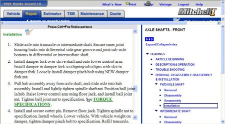

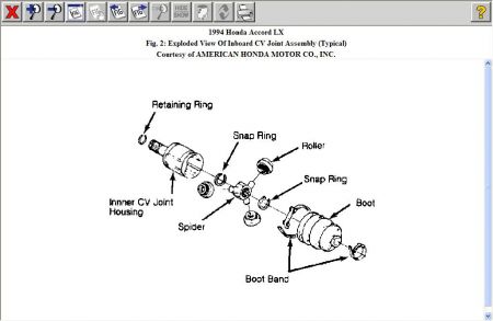

If I pry the axle out and slap the new one in,what clip has to be depressed and if its on the tranny side of the axle how do you get to it?Good idea about the oil seal,I would of forgot..Thanks
Aug 7, 2008 at 2:23 PM
  • 75,992 POSTS
Dunno when Docfixit is coming back we have to take you out-see instruction below if its the front axle you're dealing with. Make sure the retaining ring locks in place
