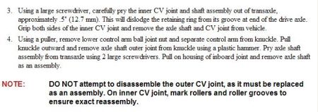

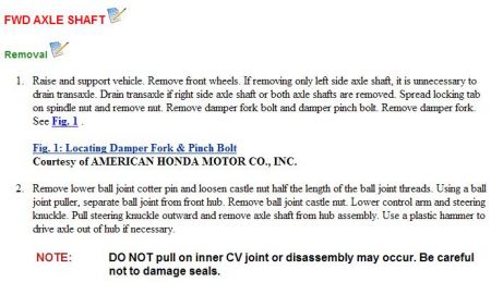

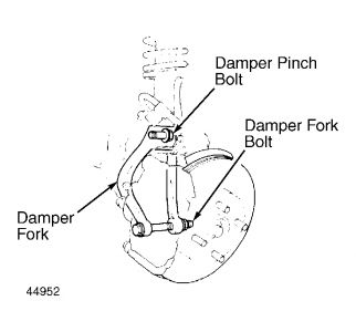

1991 Honda Accord 4 cyl Two Wheel Drive Automatic
when making a left turn sounds like thug-thug-thug, like hitting against it has been replaced before about a year ago same problem I really appreciate your help on this thanks.
Thursday, November 13th, 2008 AT 3:49 AM
MHPAUTOS
  • 31,937 POSTS
For axle removal see text.
