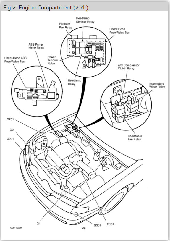

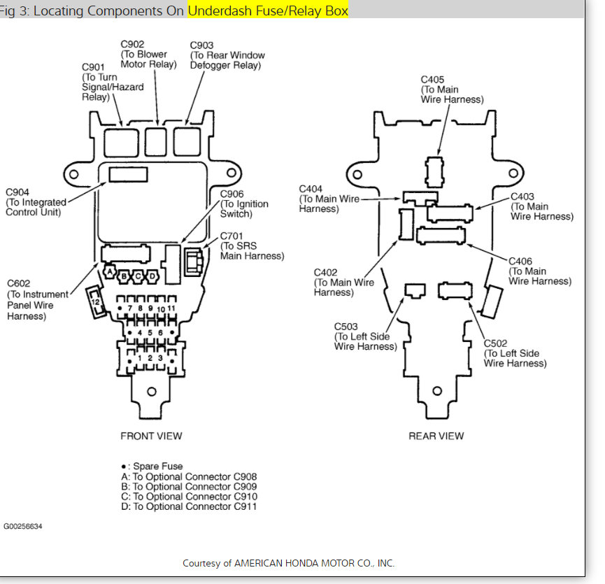

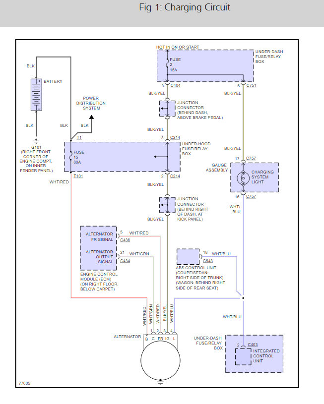

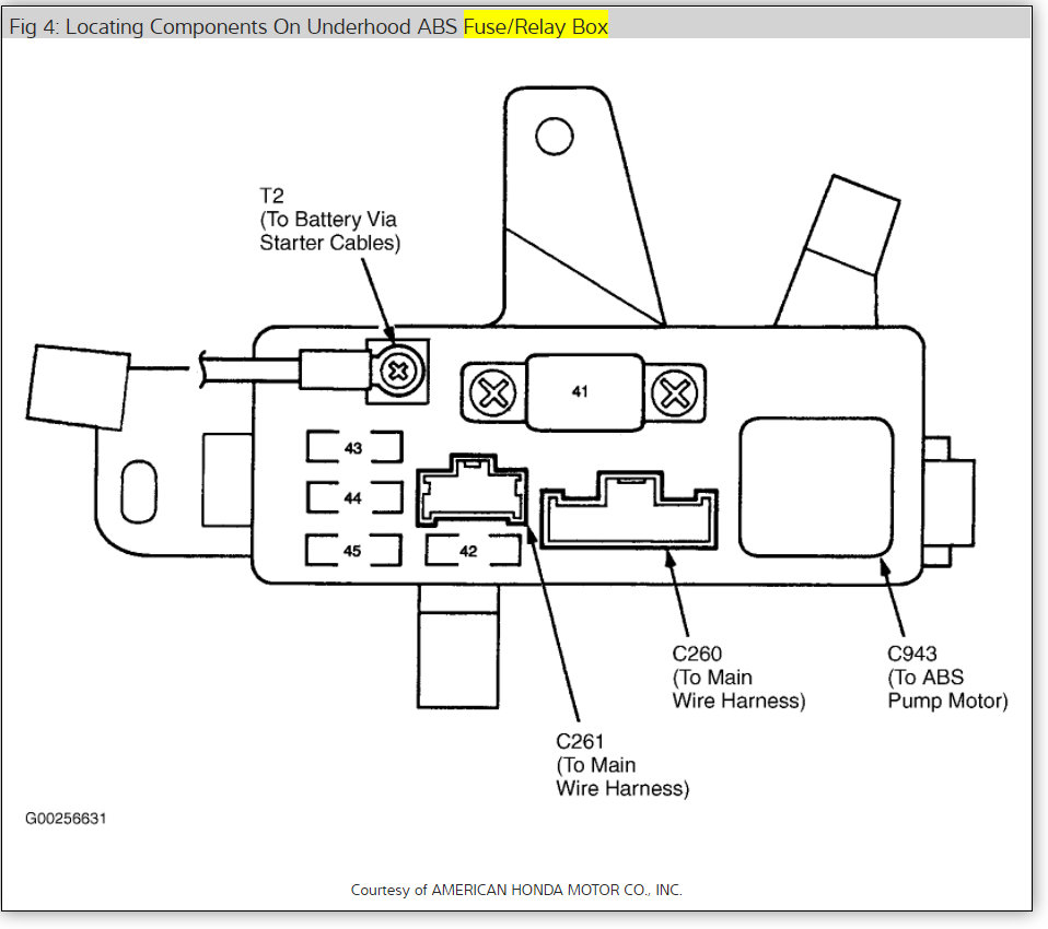

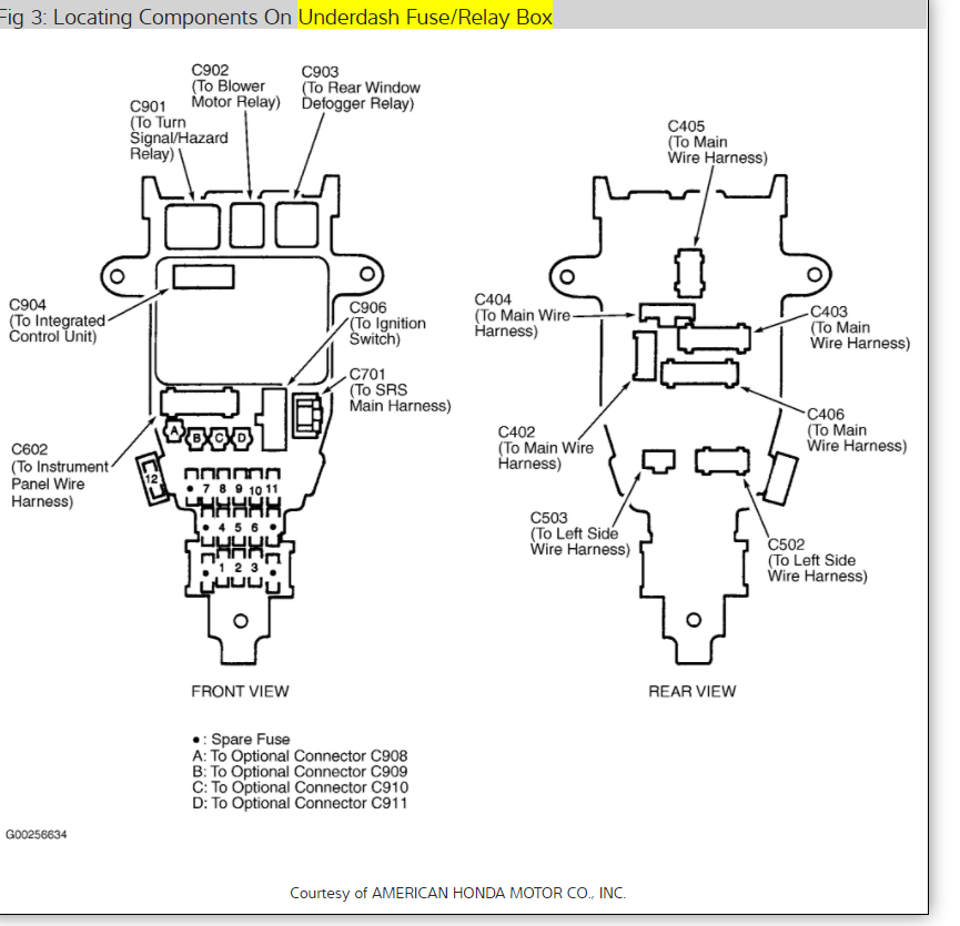

There is a fuse #2 in the under dash fuse panel here is a guide and the wiring diagrams below with the fuse location as well.

1.With engine at normal operating temperature, remove alternator harness connector. See Fig. 1 . Turn ignition switch to ON position.
https://www.2carpros.com/forum/automotive_pictures/192750_Alternator93AccordFig01_1.jpg
2.Check for battery voltage between Black/Yellow wire terminal of harness connector and ground. Ensure battery voltage is also present between White/Green wire terminal and ground. If battery voltage is present, go to step 4).
3.If battery voltage is not present, check dash fuse No. 2 (15A). Check for open circuit in Black/Yellow wire between dash fuse box and alternator. Check for open circuit in White/Green wire between PGM-FI ECM and alternator.

I had this problem it was the fuse!
