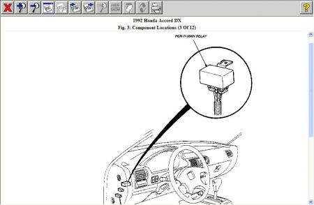

You are welcomed. Sorry if I had not been clear with my reply. When I mentioned the dashlights, I meant the indicator lights and as the charge indicator is on, it means the ignition switch should be ok. Here is a location diagram of the PGM-FI main relay.
https://images.2carpros.com/forum/automotive_pictures/192750_PGMFIRelay92Accord_7.jpg
Yes, looks can be deceiving. Remove the relay and do a visual inspection of it. If the terminals have signs of cracked solders on any of the joints, resolder them and it should be as good as new. You would have to get the starter working so as to be able to crank the engine.
