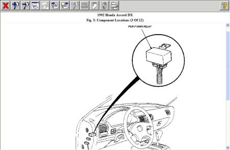

Seems the problem is likely caused by an intermittently malfunctioning PGM-FI main relay. Remove it and resolder the circuit board to test if it helps.
https://www.2carpros.com/forum/automotive_pictures/192750_PGMFIRelay92Accord_6.jpg
Btw check if the dash indicator lights are showing when vehicle stalled. If they do not show, the problem is caused by a bad ignition switch.
