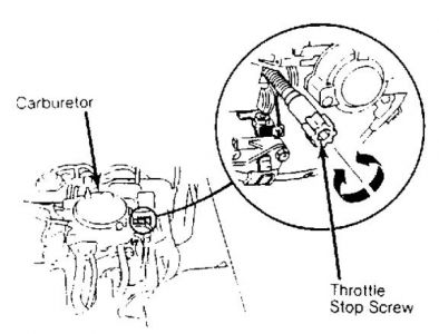

Sorry, I made a mistake about the fuel cut relay, it should be fuel cut solenoid located on the carb nearest the firewall.
It is a solenoid that if it does not work, will cut fuel supply for the idling circuit. Solenoid is located next to throttle adjust screw.
https://www.2carpros.com/forum/automotive_pictures/192750_ThrottlestopScrew89Accord_1.jpg
Disconnect the wire and apply battery voltage, it should click.
The idling circuit is the circuit inside the carb for fuel and air mixture to be drawn into manifold during idling.
The feedback carb system would control the idling circuit as well but the throttl position sensore seldom gives any problem. You would need to check the ECU under the seat.
