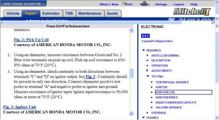

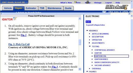

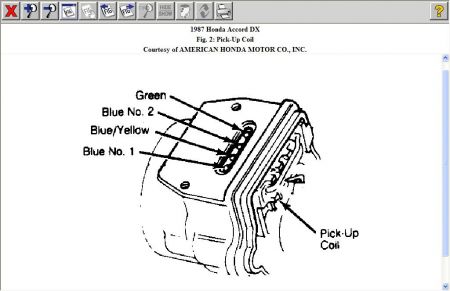

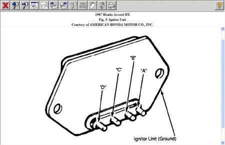

I was hoping you could tell me where the ignition module is located and how I can test it, what the specs are and how to remove and replace it.
I know my no start problem has something to do with the ignition system and I have already ruled out the ignition coil and wires as a problem, now all I need to check is the distributor cap and rotor and the module.. but I have no Idea what the module looks like or anything...
I would appreciate your help! thanks!
Feb 28, 2009 at 4:10 PM
  • CAR REPAIR CONTRIBUTOR
  • 75,992 POSTS
The ignition module is the Ignitor-Good Luck
