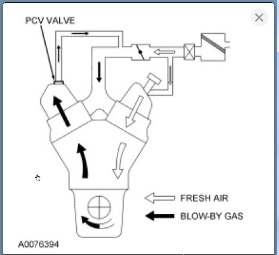

The blue smoke is going to be oil getting burned through the engine and due to the amount that you are finding I would think it is rings. This is called blow by.
https://www.2carpros.com/articles/blue-smoke-from-engines-exhaust

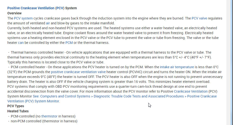

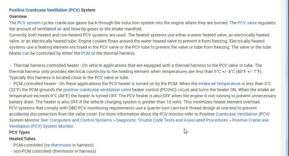

We want to check the PCV and make sure this is not clogged. While I don't think this is going to solve the issue it will be a good indication as to this is the issue. I attached the info below on this for your review.
