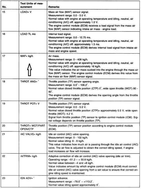

Just for argument's sake, I tried again with the brake cleaner. still had some dirt around anyhow. cleaned it off, then 15 seconds later my idle went down to 700 Rpms and stayed there for well over 5 seconds. it was odd, idled lower like it should. I then used an entire can of brake cleaner trying to replicate it but I was unsuccessful. Also, Maf sensor reads 1.24v at idle but should be at 1v. Also that chart you sent says maf should read 16 kgh, I have about a pound per minute reading on my scanner which equals 60lb hr or 27 kgh according to my math. So I'm running about roughly double the air I should through my maf? But idle is high, so that value is skewed. But still. Soft reset unsuccessful as well. I'm not sure how to test most of the other items on that chart as my scanner doesn't show values for them.

Update, I finished my coil wires after my cars idle shot up to 1500-1900 rpms. My cat started to glow a bit. I still have a miss/stumble but my knock sensors dont register it anymore. Idle went back to previous amount but it still has a high metered flow reading on the maf sensor and the iacv is closed fully. Acts like a vacuum leak, but can't find one, and the extra air is metered, not unmetered. Is the computer changing the maf sensor values?

The reading could be caused by the high idle. Kinda odd the idle did actually go down for a bit? It would sound like you have a vacuum leak somewhere? Also what brand idle air control valve did you install?
