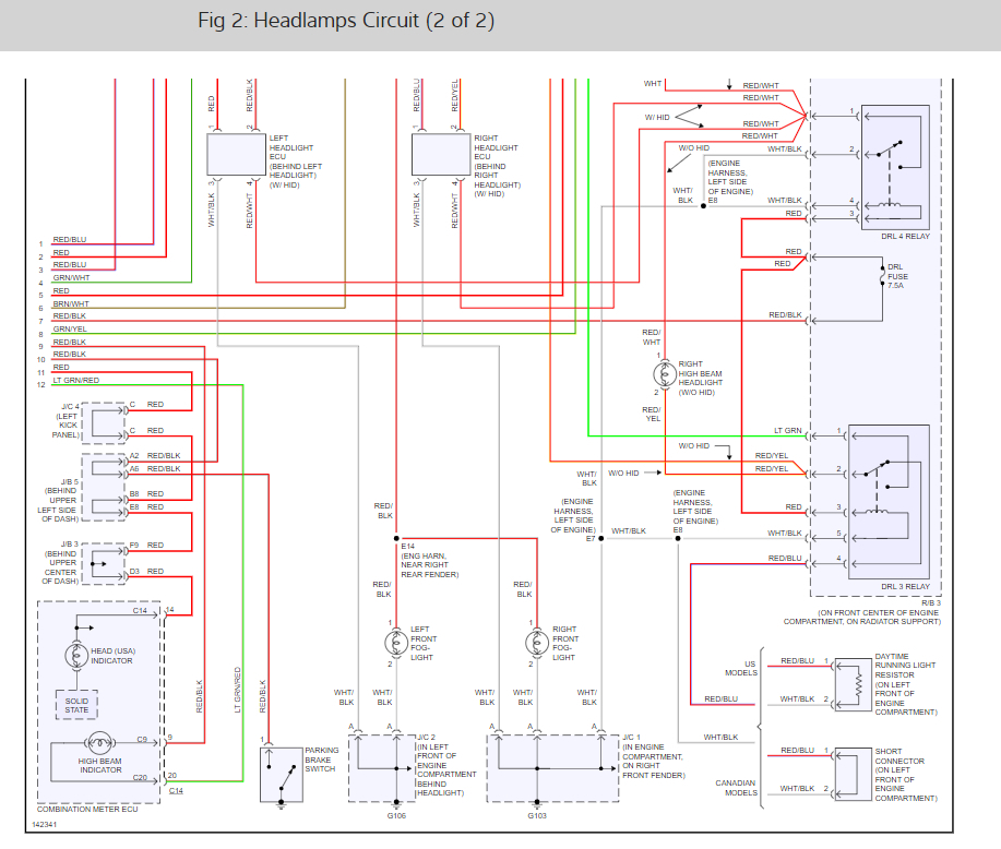

Need to swap my OEM HID's for halogens
50,000 MILES • 3.0L • V6 • 4WD • AUTOMATIC
JBRISH

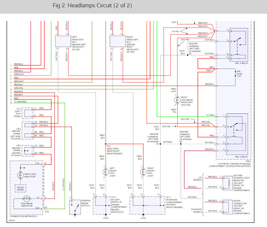

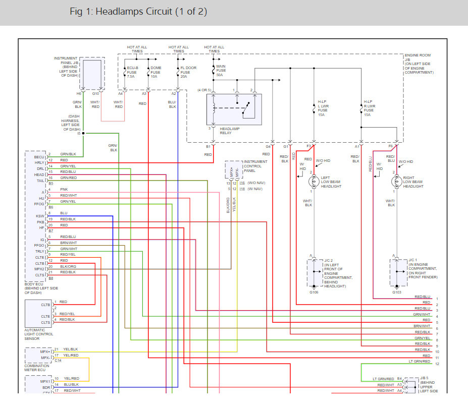

Because HID assemblies are too expensive where I live. If I were to remove the old ballasts, there would be two wires each side. I believe one is a control wire and the other is 12V. How do I hook up wiring for both high and low halogen beams? Do I need relays in this case?
Thanks!
Jan 14, 2020 at 10:38 PM
  • 55,709 POSTS

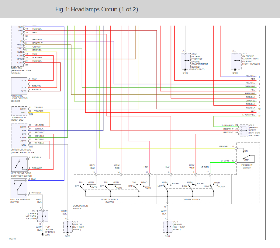

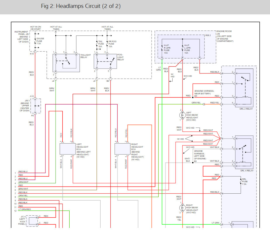

I have included the headlight wiring diagrams so you can see how the system works and which wires to connect to your HID system.
Jan 16, 2020 at 2:41 AM
JBRISH
Hello, thank you for the diagrams. is the headlight 'ECU' for HID lights refer to the ballasts?
Jan 16, 2020 at 6:53 AM
  • 55,709 POSTS
I believe so. Do you have a picture of the ballasts?
