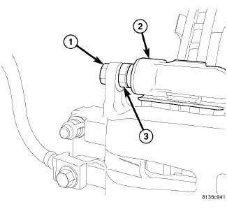

We change rear brakes about month ago and yesterday when driving forty to fifty mph and applying the brakes get big vibration and could feel it in the steering wheel. I was told could be a bent disk or bad rotor. I think I need brakes.

1. Completely retract caliper piston(s) back into bore(s) of caliper. To do so:
a. Remove fluid reservoir cap.
b. Use hand pressure or a C-clamp may be used to retract piston, first placing a wood block over piston(s) before installing C-clamp to avoid damaging piston(s).
c. Install fluid reservoir cap.
pic 1

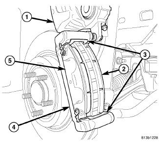

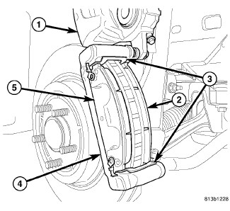

2. If removed, attach anti-rattle clips (3) to upper and lower abutments of adapter (4).
3. If equipped, remove the film from the brake pad double sticky isolator.
4. Install NEW inboard (2) and outboard (5) brake pads on caliper adapter (4). NEW Inboard and outboard pads are interchangeable.
5. Push caliper guide pins into caliper adapter to clear caliper mounting bosses when installing.
6. Rotate caliper downward, aligning upper mounting boss with lower guide pin.
pic 2
7. Install Upper caliper guide pin bolt (1). While holding guide pin (3) stationary tighten bolt to 60 Nm (44 ft. lbs.).

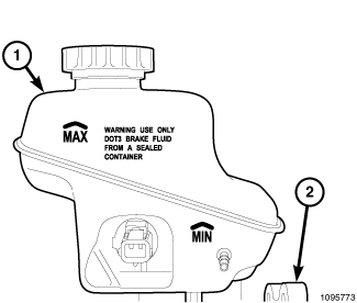

11. Check and adjust brake fluid level in reservoir (1).

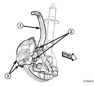

1. Raise and support vehicle. See: Maintenance > Components
pic 5

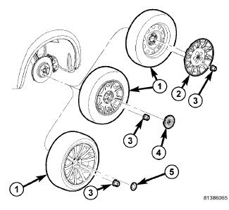

2. Remove wheel mounting nuts(3), then tire and wheel assembly (1).
NOTE: In some cases, it may be necessary to retract caliper piston in its bore a small amount in order to provide sufficient clearance between shoes and rotor to easily remove caliper from knuckle. This can usually be accomplished before mounting bolts are removed, by grasping rear of caliper and pulling outward working with guide pins, thus retracting piston. Never push on piston directly as it may get damaged.

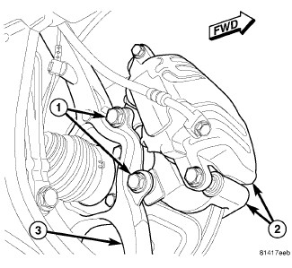

3. AWD - Remove two bolts (1) securing disc brake caliper and adapter (2) to knuckle (3).
4. AWD - Remove disc brake caliper and adapter (2) from knuckle (3) as an assembly. Hang assembly out of way using wire or a bungee cord. Use care not to overextend brake hose when doing this.

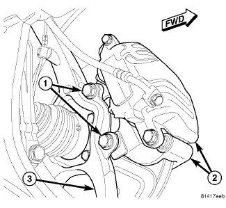

5. RWD - Remove two bolts (2) securing disc brake caliper and adapter (3) to knuckle (1).
6. RWD - Remove disc brake caliper and adapter (3) from knuckle (1) as an assembly. Hang assembly out of way using wire or a bungee cord. Use care not to overextend brake hose when doing this.

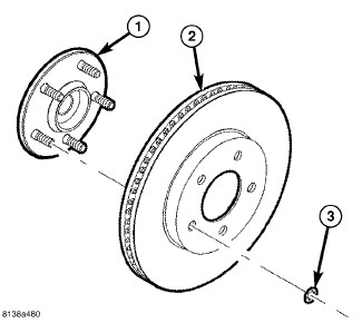

7. Remove any clips (3) retaining brake rotor (2) to wheel studs.
8. Slide brake rotor (2) off hub and bearing (1).

1. Clean hub face (1) to remove any dirt or corrosion where rotor mounts.
2. Install brake rotor (2) over studs on hub and bearing.

5. RWD - Install disc brake caliper and adapter assembly (3) over brake rotor.
6. RWD - Install mounting bolts (2) securing caliper adapter (3) to knuckle (1). Tighten bolts to 95 Nm (70 ft. lbs.).
7. Install tire and wheel assembly (1) See: Wheels and Tires > Removal and Replacement > Tires And Wheels - Installation.

10. Check and adjust brake fluid level in reservoir (1) as necessary.
