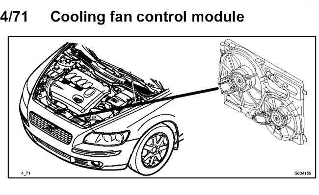

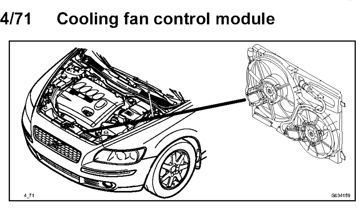

That display feature might have helped as that way you would know how hot the engine gets before the fan kick in. The fan operation control by the module and the coolant temperature sensor.
I did some digging and found that there was a recall a while back for the fan control module. Not sure if the recall is still active. Might want to call your local dealer and give them your VIN they can tell you if that recall was performed or if it is still open. Recall #214
Fan control module.
