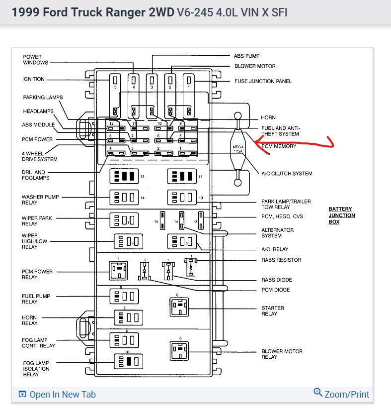

I drove my truck in the river and it shut off and sat there for over a week. When I got it out, I let it dry, but then I'm not getting power to half of my fuses the water got up to the floorboard but no higher.

I would check the maxi fuses under the hood.
Here is a guide to help:
