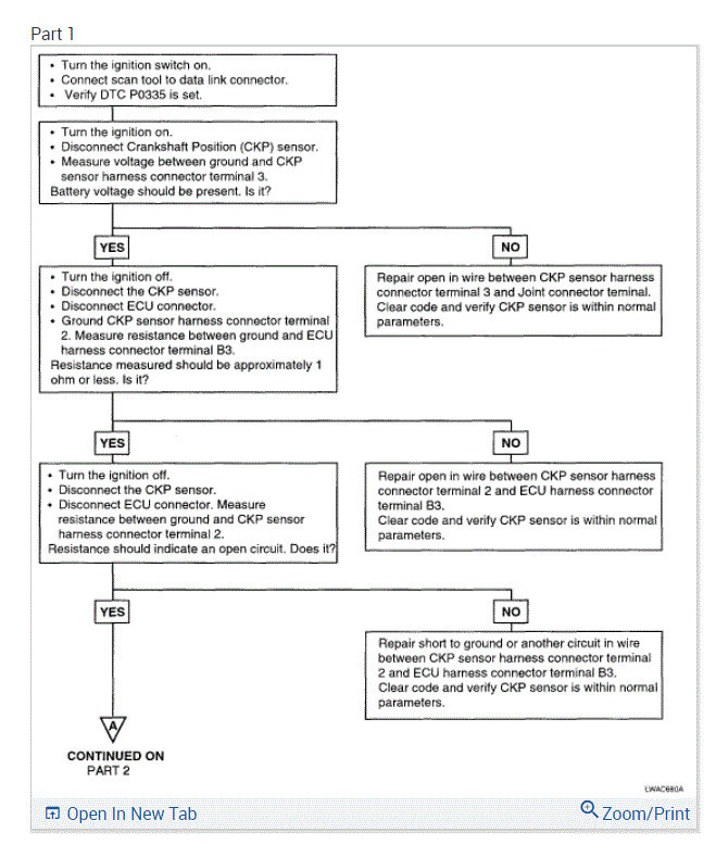

My car started spitting sputter then shuts off wait 15 minutes and usually starts up and can drive anywhere from 15 to 5 miles them does it again.. No fuses blown. engine light is on but has been on since I have had it says fuel temperature sensor bad.. New fuel pump, stumped.

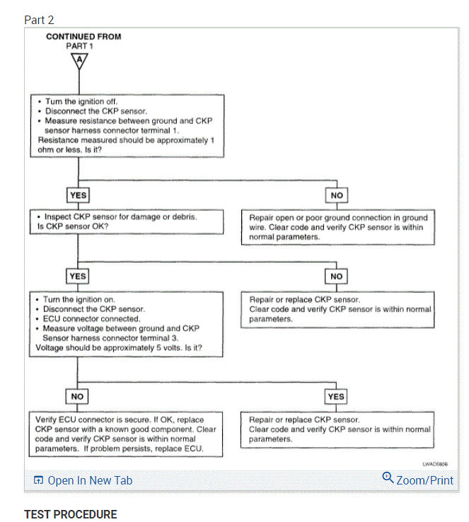

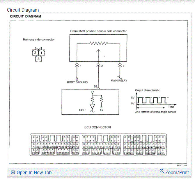

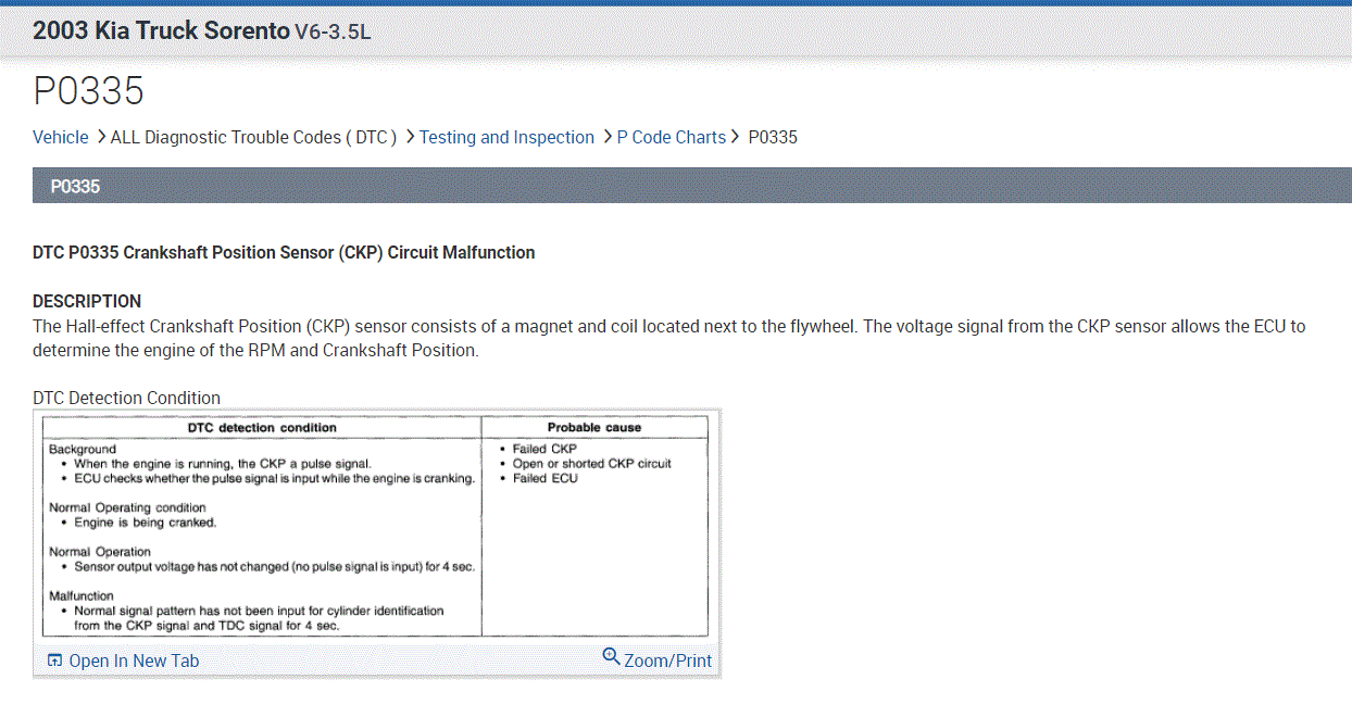

The codes are p0335 p0340. still doing the same thing. cleaned MAF sensor and I guess next is camshaft sensors. I guess it acts like it's starving for fuel or not enough pressure in the fuel lines.

One code for the crankshaft position sensor and one for an oxygen sensor. If I had to guess which I would address first, I would say the crankshaft position sensor (CKP).
Do me a favor. Take a look through this link and let me know if you recognize any of the conditions mentioned.
I don't know if you have access to a live data scanner, but if you do, check the short-term fuel trims and let me know what is found.
Also, below, I attached the diagnostics for the CKP code (P0335). Let me know if you are comfortable performing them.
