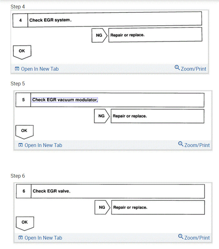

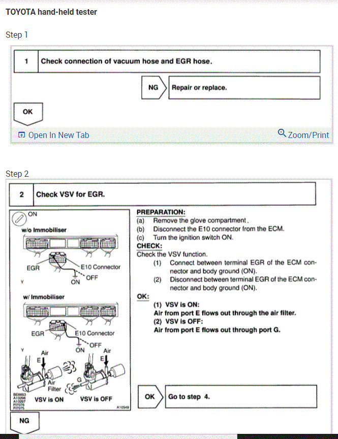

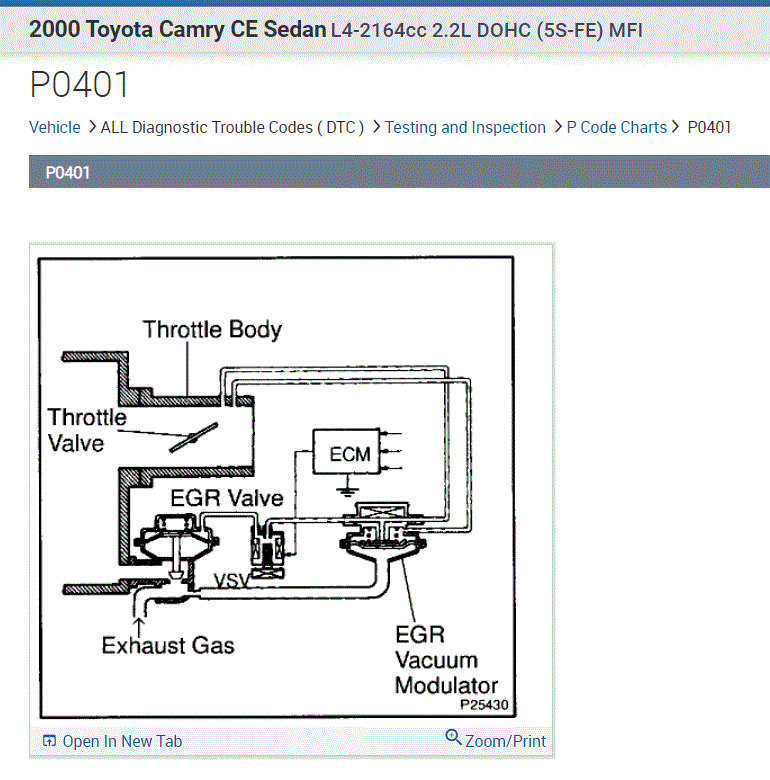

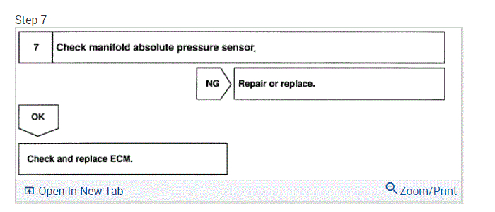

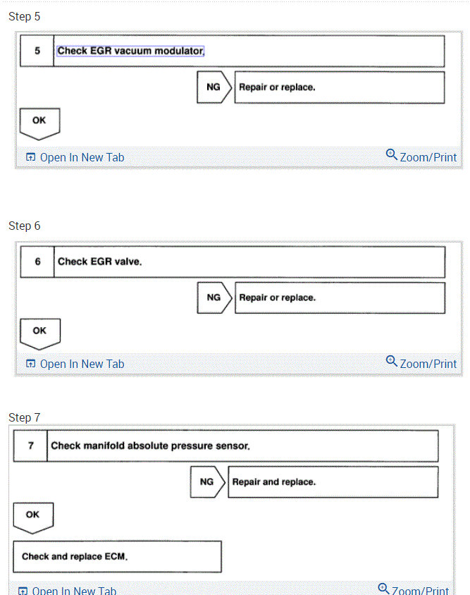

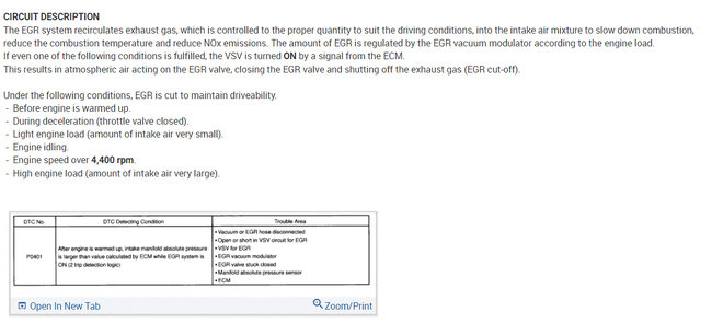

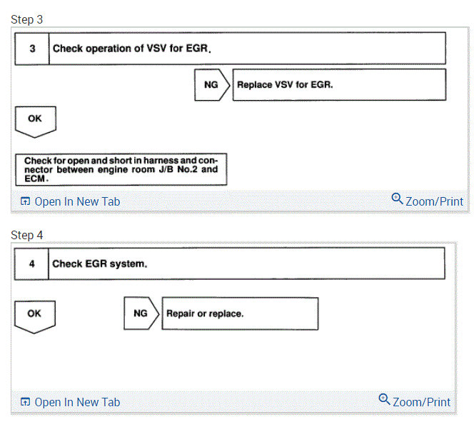

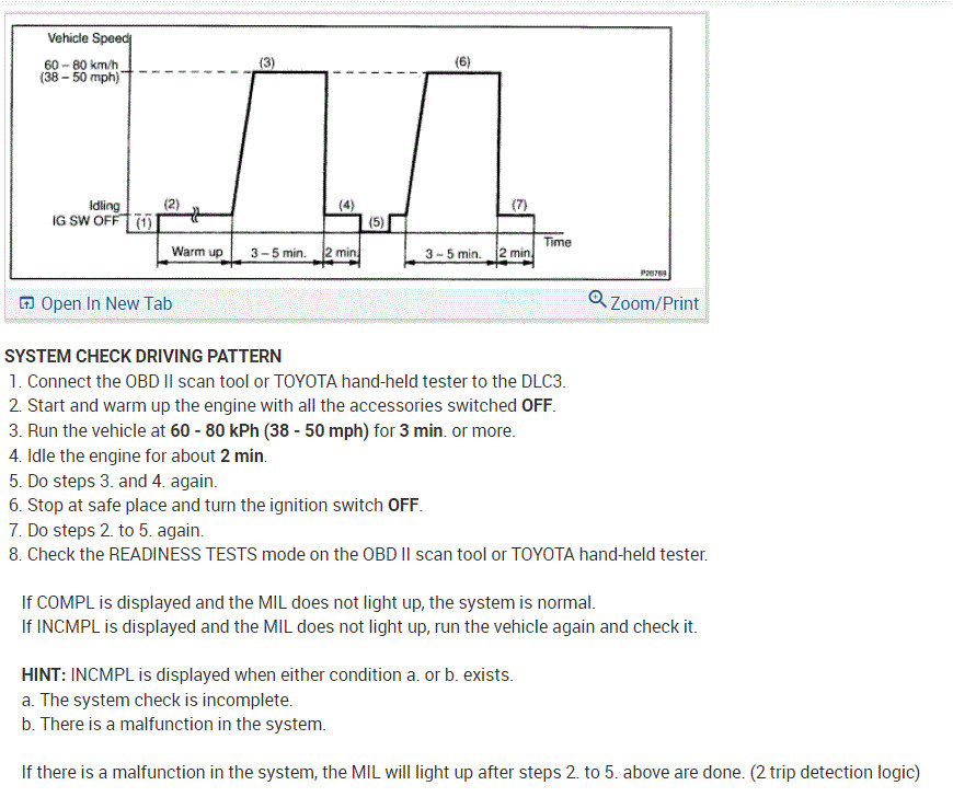

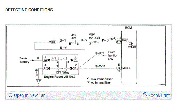

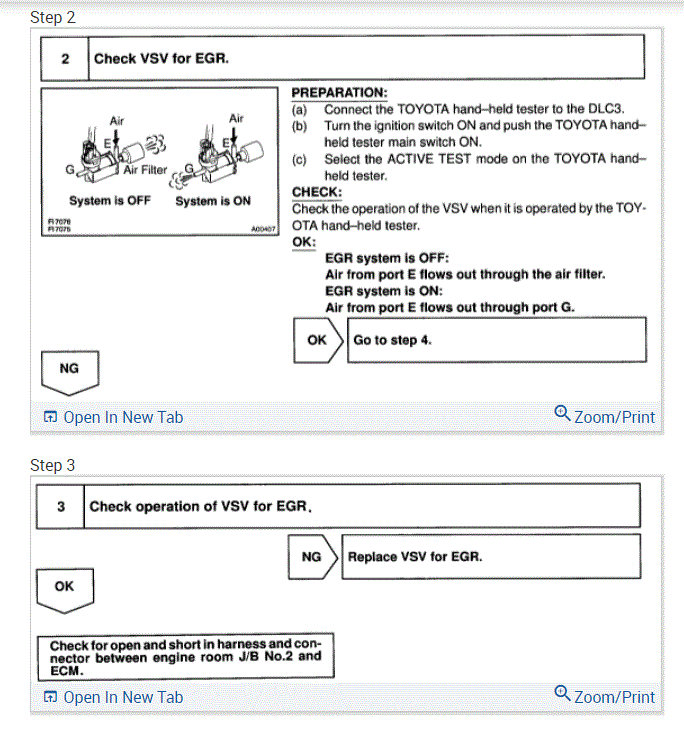

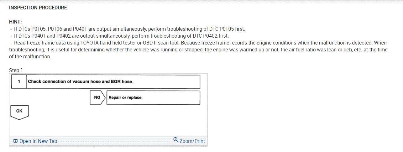

Interesting that the problem stops when the engine is cool. Under cold conditions, the EGR is shut down. So, it doesn't necessarily sound like the EGR is bad or sticking. I honestly suspect a vacuum leak. I could be wrong, but that is my first suspect.
If you look below, I included the diagnostics for a P0401. They are extensive. Take a look through them and let me know if it is something you are comfortable doing.

Before this last message you sent, I noticed that the vacuum hose connected to the Q port of the EGR modulator was hanging loose, but because I didn't know where to connect it, I left it like that. But after seeing the schematic diagram of the EGR valve connections in one of the pictures you sent, I discovered that the hose was to be plugged into the VSV, so I plugged it back in. Also, I removed the EGR valve to check it's condition, it was still working, but had a lot of carbon deposits, so I cleaned it up and installed it back in.
