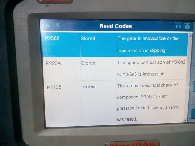

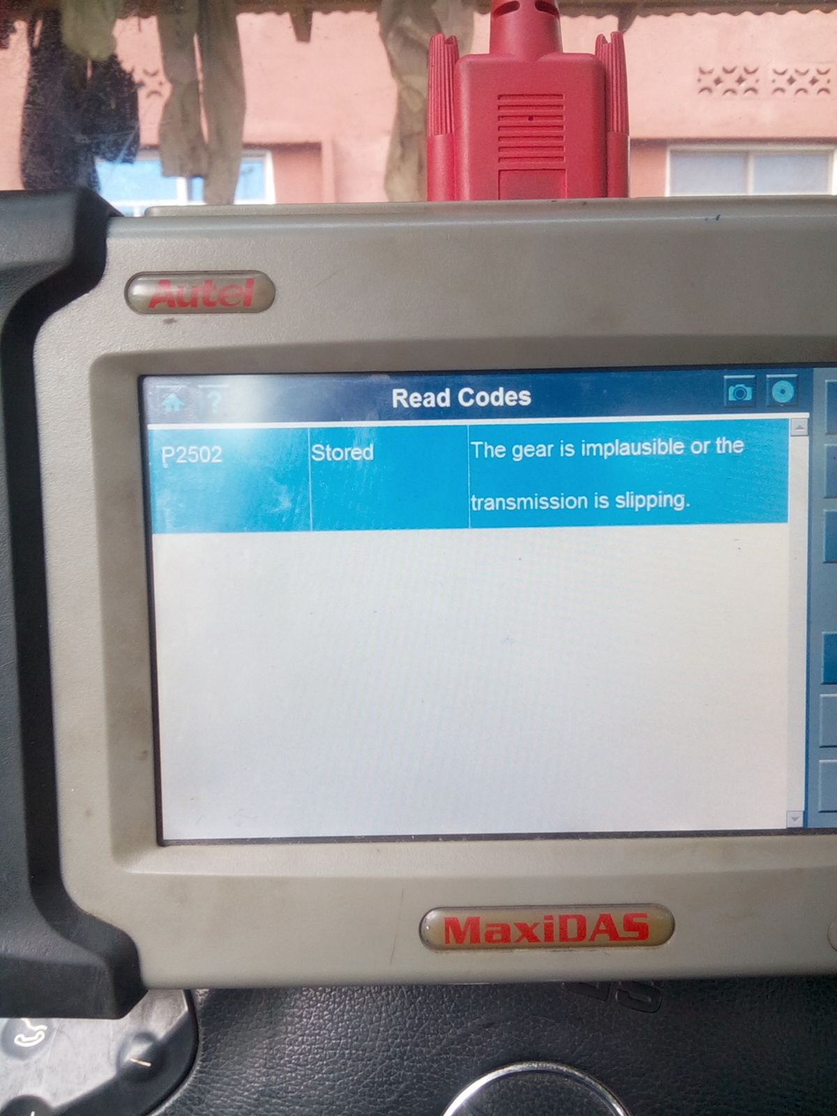

Good morning, this vehicle hesitates while accelerating and when one decelerate for something like bump on the highway. the vehicle won't be able pass (climb over) the bump, at this point, you might press down the gas pedal, the engine speed will keep on increasing but the transmission is not responding. I have to put the transmission in park position, off the engine on the highway and restart the engine again, then place the transmission in drive position before it can overcome that obstacle. I scanned the vehicle the only code I saw on the transmission system is shown below. The gear box was newly changed, could the problem be the gear box itself or what?

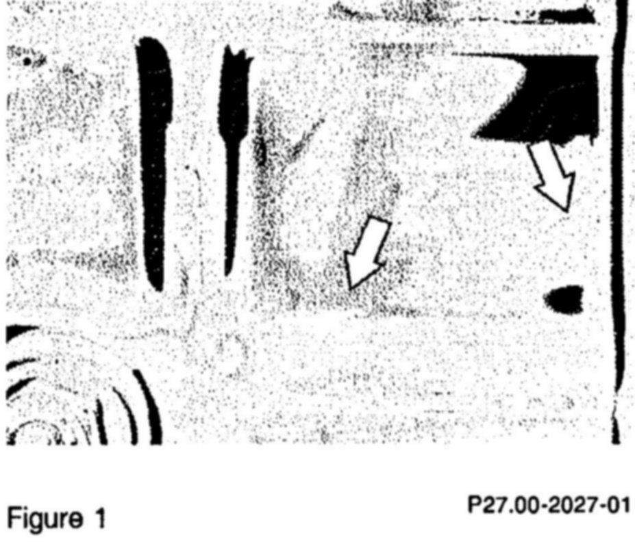

See pic 3
Large metal shavings, in millimeter size
Mechanical damage to transmission

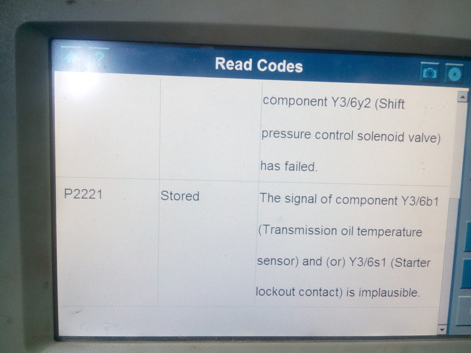

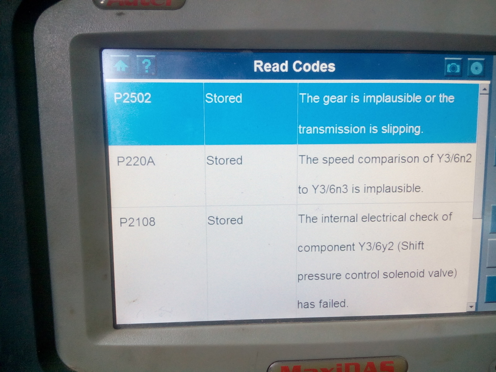

Test driving the vehicle today more codes were found on its "Electronic Transmission control", they are shown below.

HHT is a reference to a scan tool for Mercedes. They are recommending that you retrieve any trans codes before you make repairs.

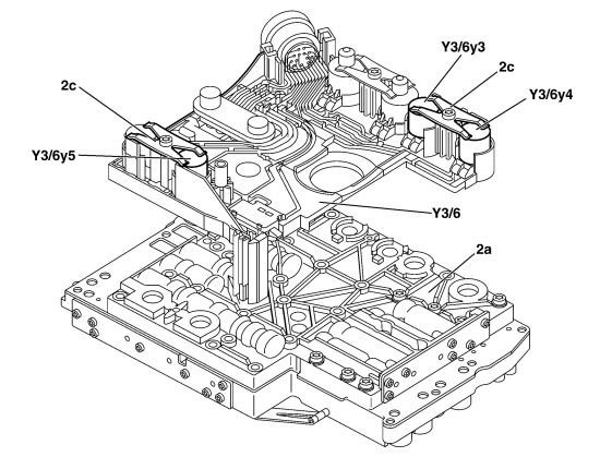

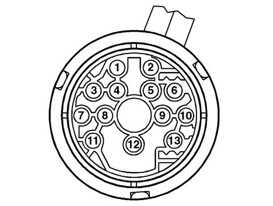

Here are the directions for diagnosing the issue related to the 2108. This is the likely cause of the problem. It could be an electrical failure or mechanical in the valve body. The attached pics correlate with the directions.
_______________
2003 Mercedes Benz C 240 Sedan (203.061) V6-2.6L (112.912)
The internal electrical check of component Y3/6y2 (Shift pressure control solenoid valve) has failed.
Vehicle ALL Diagnostic Trouble Codes ( DTC ) Testing and Inspection P Code Charts P2108 722.6 (5-gear) ETC Main as of 2001 The internal electrical check of component Y3/6y2 (Shift pressure control solenoid valve) has failed.
THE INTERNAL ELECTRICAL CHECK OF COMPONENT Y3/6Y2 (SHIFT PRESSURE CONTROL SOLENOID VALVE) HAS FAILED.

Test 1: Check component Y3/6y2 (Shift pressure control solenoid valve).
1. Check component Y3/6y2 (Shift pressure control solenoid valve).
Operation number of operation texts and work units or standard texts and flat rates:27-0641Test prerequisites
- Erase fault memory.
- The power supply of component is okay.
Test sequence
- Switch off ignition.
- Connect socket box.
- Measure resistance with multimeter between sockets [2.37] 37 and [2.38] 38 of the 126-pole socket box tester.
Specified value:
- Resistor[4.0...8.0]ohms
Question
- Is the measurement value okay?
see pic 1

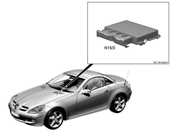

The measurement value is okay. Possible cause
- Internal fault in component N15/3 (ETC [EGS] control unit):
Possible remedy
- Replace component N15/3 (ETC [EGS] control unit).
Notes on submitting warranty or goodwill claims
- SEAG damage code (7 digits):54 553 73
End of test

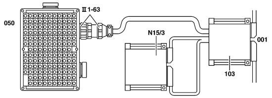

Test prerequisites
- The measurement value is not okay.
Additional measures
- Disconnect socket box.
- Separate plug connection at transmission.
- Measure resistance.
Test sequence
- Measure resistance with multimeter between 10 and 6
Specified value:
Question
see pic 3

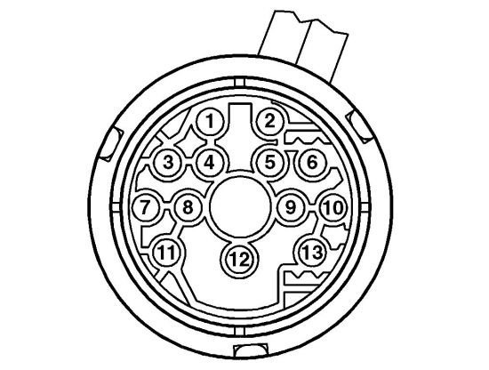

NO
Test prerequisites
Additional measures
- Remove component as per the repair instructions.
- Repeat internal resistance measurement on component when removed.
Test sequence
- Measure resistance with multimeter between 1 and 2
Specified value:
Question
see pic 4
YES
- Fault in supporting body of component Y3/6 (electrical control module)
Possible remedy
- Replace supporting body on component Y3/6 (electrical control module).
- SEAG damage code (7 digits):27 264 73
End of test
see pic 5
NO
The measurement value is not okay. Possible cause
- Component is defective.
Possible remedy
- Replace component .
- SEAG damage code (7 digits):27 226 73
End of test
see pic 6
