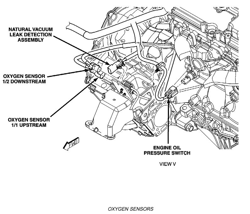

My questions are thus...
I want to replace my spark plugs, and oil pressure sensor, which I'm not sure where to find its location. I believe that I have bought all the tools necessary for the job. I'm a beginner.
Can you please guide me on where to look?

Lets start with the oil pressure switch. It's shown in this drawing. Why do you need to replace it?
Code P301 is for cylinder # 1 misfire. There's a chance new spark plugs will solve that one.
