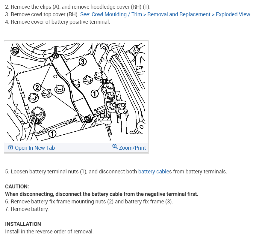

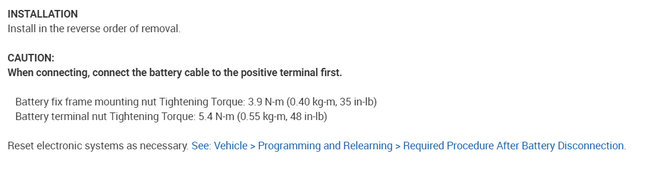

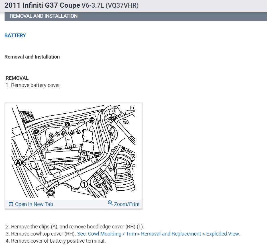

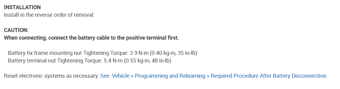

The fact that the key light is on means the security system is engaged but I think it might be a battery issue. So, let's use this guide to load test the battery, it's easy. Then if okay let's run the codes to see what comes up. you can get a code scanner from Amazon for about $20.00.
Here is a video to show you how. but first:
and
Here is a scanner link:
https://amzn.to/3Qi1SS6
